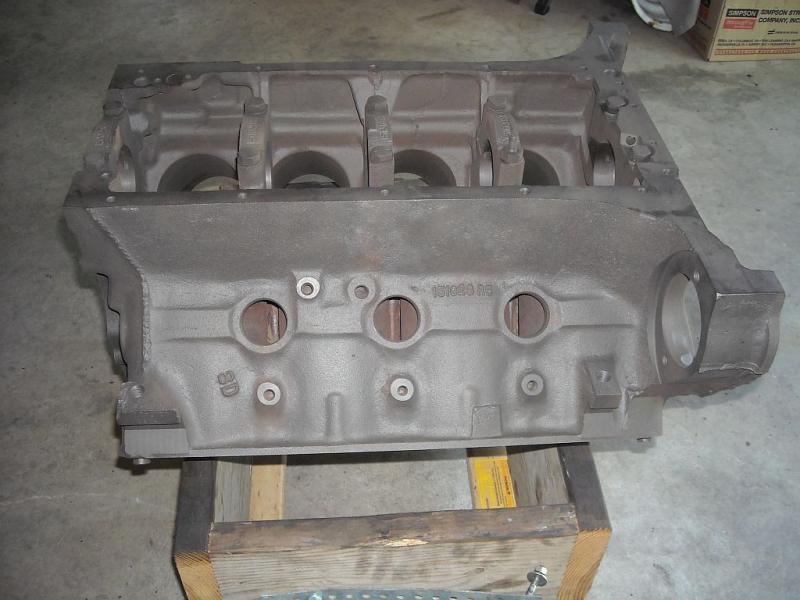

This is a 345 block that has just come out of bake and blast at the machine shop. It's sitting upside down of course on the dolley. Look in the lower left hand corner of the block pic and you will see the pad along with a number stamped on this one.
Any engine block that has a number string cast into it is simply either apart number for the bare block before machining or some sort of identification for tracking the mold/die/fixture/tooling that was involved with manufacturing the part in order to be able to qa and correct and manufacturing defect discovered down the line.
