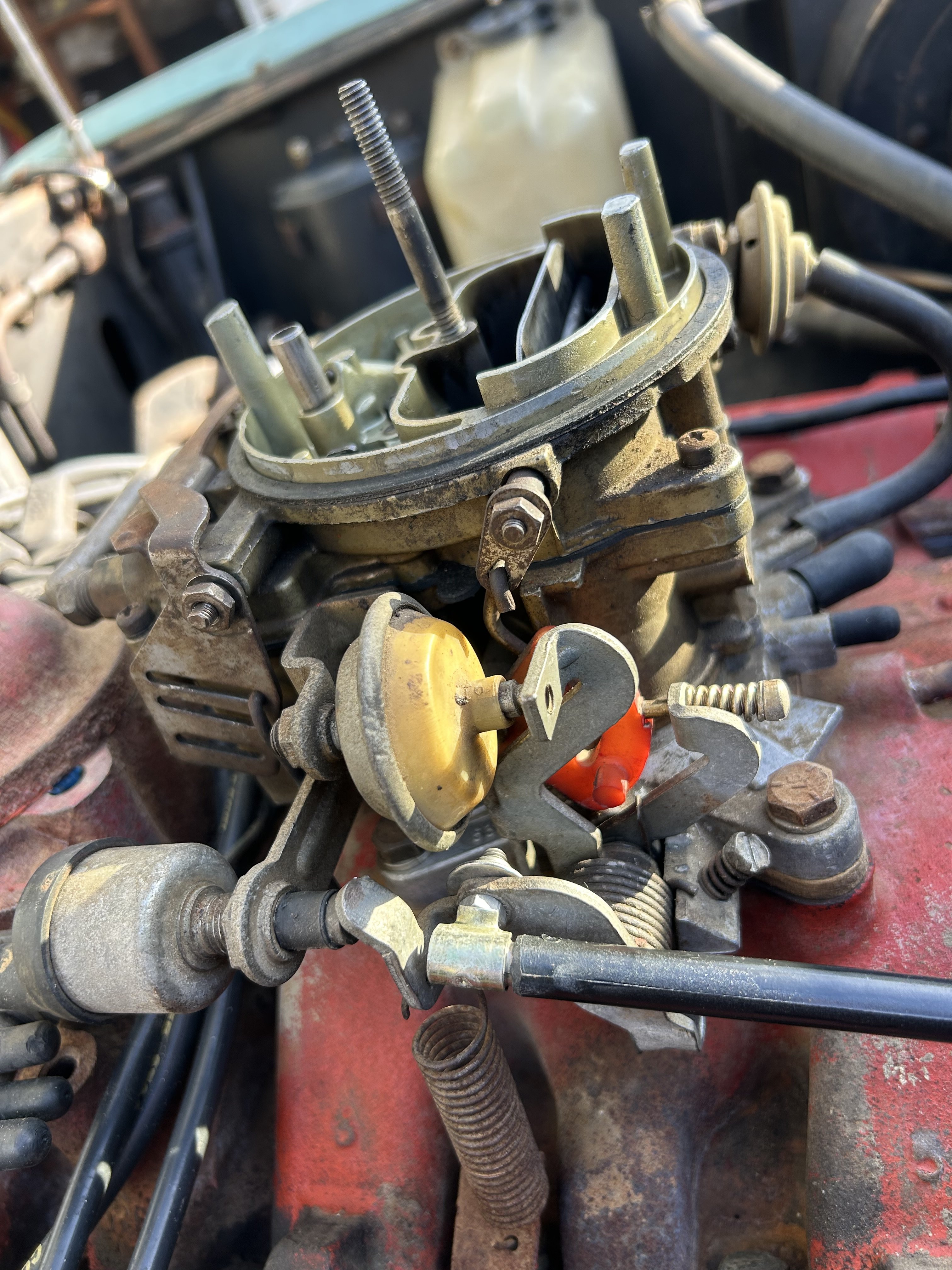

Does anyone have any good close up pics of the spring on the fast idle cam on a 2210 carb?
Mine seems to be missing. There isn’t one on the carb or anywhere on the manifold if it came off somehow and the cam and it’s linkage aren’t functioning/interacting with the choke as intended.

IIRC the cam works by gravity. If its sticking a shot of carb cleaner on the pivot should clean things up.
