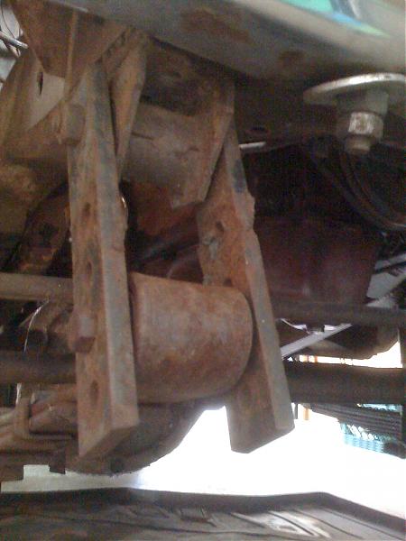

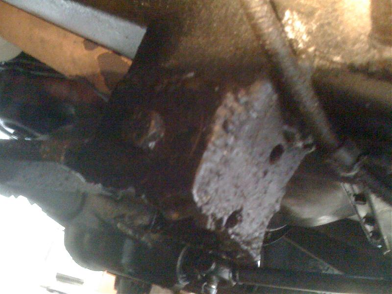

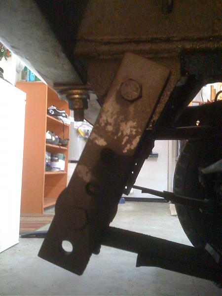

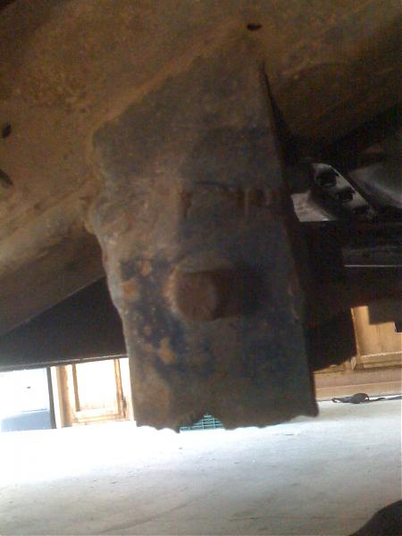

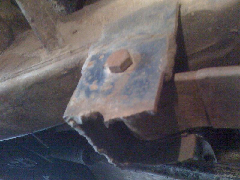

My second question for the night is how bad is this set-up. I am not a welder, but these look pretty bad (unsafe) to me. Should I be getting this entire thing redone. The back suspension set-up looks good, but the front appears to my ignorant eye to be a rookie job. See pics...
Secondly, if I have to go ahead and have all this re-welded should I just go for the reverse shackle at this time?
Thanks for any help.

It all looks pretty hack! If your budget allows for it and you want the reverse shackle then do it now.
I would cut that junk out and do a shackle reverse at the same time. That would drive me crazy if I had a hack job hanger like that on my rig
That is what I was sort of afraid of. Or not, gives me a great reason to do the suspension. Okay, so now the question becomes what do I go with. I talked to Jeff on the phone last week and in the end it seemed like the reverse shackle was more work than I wanted. However, now there are a new issues. There will be removal and welding needed (which I cannot do and will have to pay someone to do), so do I now go for the reverse shackle. It seems as though it improves the ride and is better for off-road situations. Almost seems like a natural fit.
I have a 2" body lift and would like to get 2-3 more so I can have 33's. I think it is time to call and figure out what I need and then try to find someone willing to remove the crap on the truck and weld the new stuff on.
