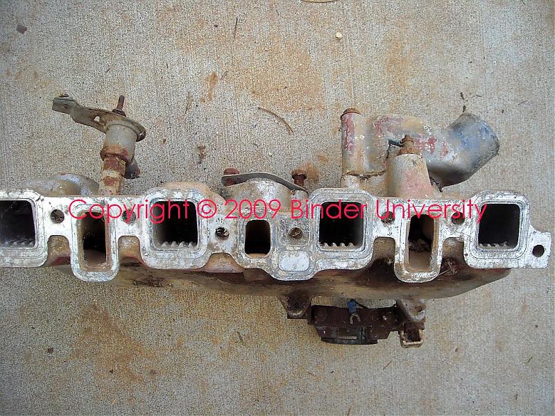

This pic is a 152t intake with the one-piece water neck, notice this manifold also has an "'active" heat riser passage, though it May have been mounted originally with an intake gasket with the heat riser blocked such as used in an lpg application.
This particular manifold is in the wiese collection.

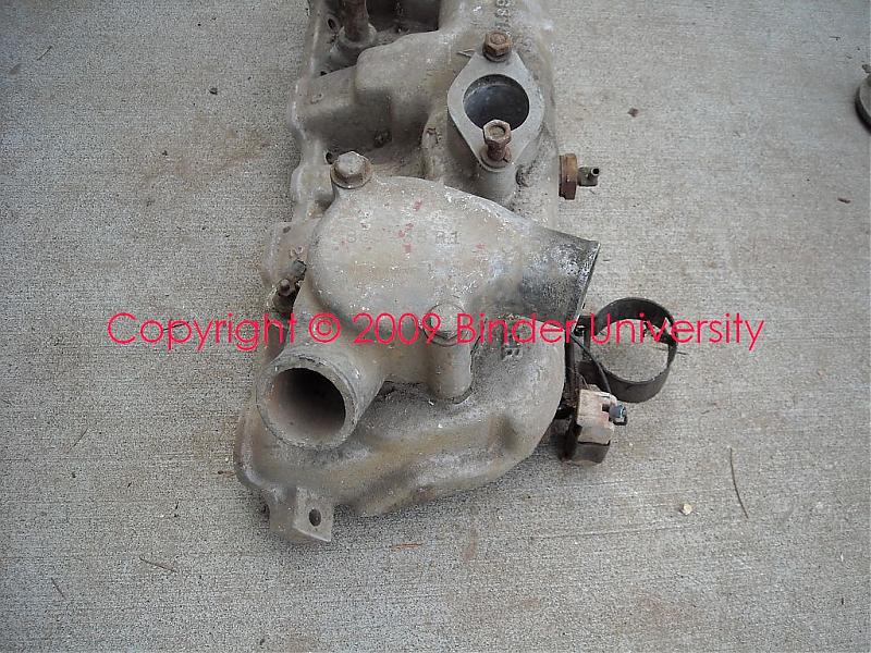

Another view...
Since these engines are very ez to cool, even with the small radiator and no shroud from the original s80 production, I see no benefit in retaining the one-piece neck.

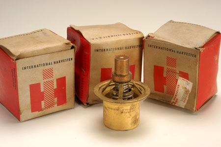

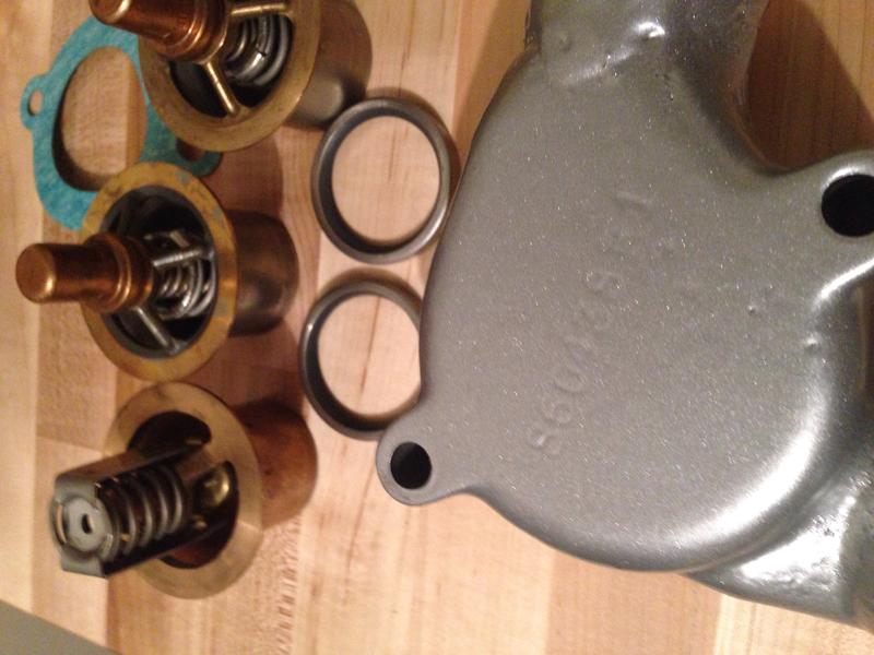

Did the aluminum t-stat housing use the same thermostat as the cast iron?
Re: Aluminum 4 cyl thermostadt housing?
The aluminum housing uses a different stat like the ones below.

Jeff advises me tonite...he's got several of those "early" t-stats on the shelf now and available.

We need to find the housing seal. Wo this seal in good working order this style of stat is a bad thing. Iirc the mt 113 shows it but I don't have the part number right now.
