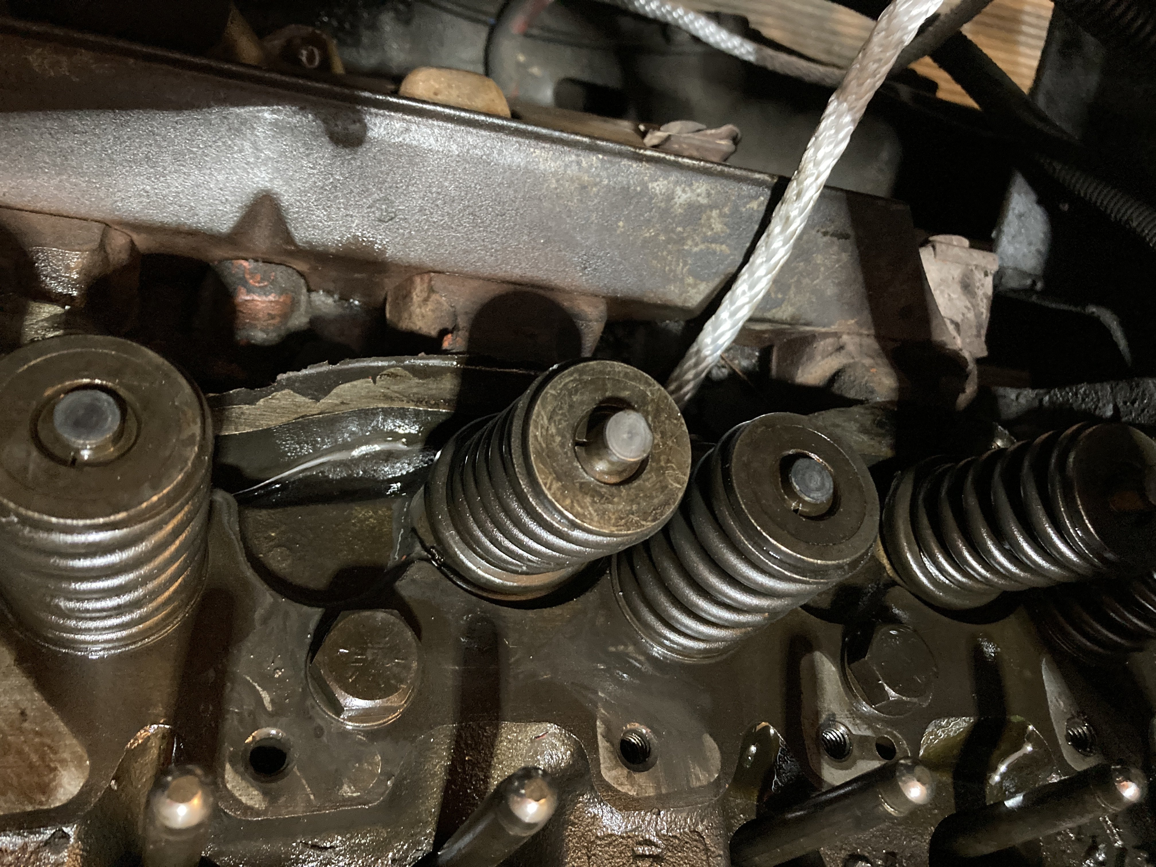

It's getting past rings then !as for the leak down, when i replaced the valve seals on that cylinder i had compressed air on that cylinder to hold up the valves. no air got past the valves, because none came out the intake or the exhaust, and nothing got in to the radiator, no bubbles, i had the heater hoses off, noting came out of them, however air did get in to the crank case, could hear it and it would cycle the compressor on
Rings always pass some air while pressurizing the cylinder.as for the leak down, when i replaced the valve seals on that cylinder i had compressed air on that cylinder to hold up the valves. no air got past the valves, because none came out the intake or the exhaust, and nothing got in to the radiator, no bubbles, i had the heater hoses off, noting came out of them, however air did get in to the crank case, could hear it and it would cycle the compressor on
