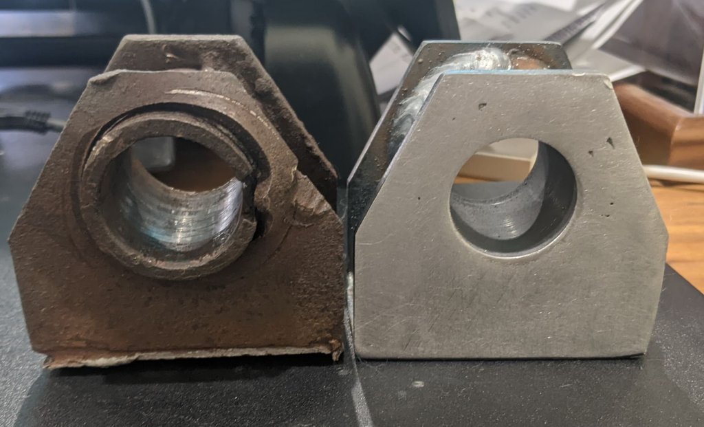

Looking for replacement front shackle mounts. I cant seem to find any for the 1 3/16" bushing instead of the 7/8". I could probably repair what I have, but I am worried about the metal being weakened, causing the original warp/sleeve dislodging.

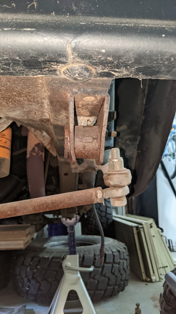

Update - GRC Fabrication made a set for me. Does anyone have measurements for stock location? Just want to make sure PO did not move them for some reason.
You can put them kind of anywhere as long as you get the shackle angle you want. Match your rear shackle angle and it should ride fine, add a touch more angle and the spring may ride nicer.
Using stock length shackles or a longer lift shackle?
