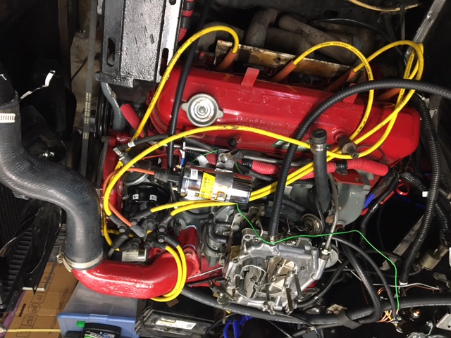

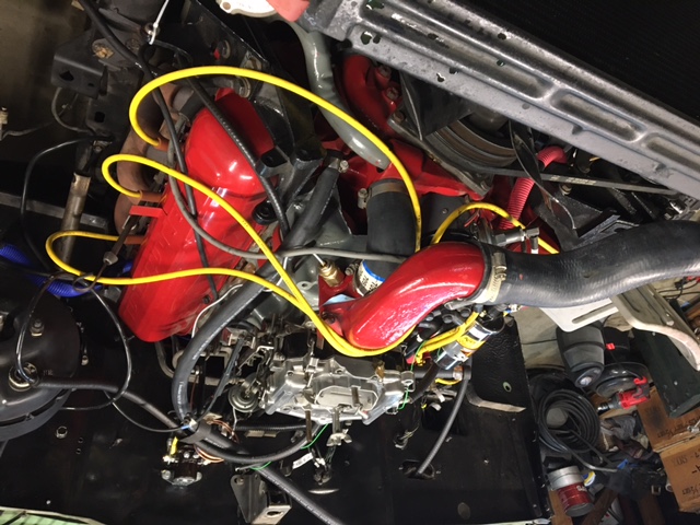

79 Traveler, 345, 4bbl TQ, 727 TF. This is a dealer engine I purchased back in 1988. It has never been run or had fluids in it until this weekend and has been sitting in my garage all this time. I did break it apart last summer to redo all of the seals knowing that rubber gets hard and cracks. all in all, the engine did not freeze up when sitting.
Just got the engine started this last weekend, ran it for about 35 min. @ 2,000 rpm to break it in with high zinc break-in oil. I did the "pre-oil", ran a drill at the oil pump groove for as long as my drill would run before it burned up, rotated the engine by hand about 15 turns. Lifters/rocker arm shafts oiled up real good while doing the pre-oil. Runs just fine but I have a couple of question.
1 - while running the break-in, the temp got up to about 225 degrees for about 5-6 minutes until I added more water into the radiator. Then the temp went back down to around 190. I have a 180 thermostat in it. Is this a concern? HELL, I hope not.
2 - Yesterday, got the engine started, timed it to right at 10 degrees, and running at about 700 RPMs. my oil pressure is at 10 lbs! I am not familiar with how low the oil pressure can get and still be functional. Is this a concern? Hell, I hope not. when "revving" the engine, the oil pressure goes up to around 45-50 lbs. Temp is right around 185-190.
3 - On the intake manifold runners (the "humps" that run to the head), I notice that the middle runners are discolored now. I also noticed this on my 77 IHC that I put a 345 into last summer. The 77 runs just fine. Is this normal, and if so, what makes the temp get so high as to discolor the runners?
All in all, I don't hear any "engine tick", engine knock, pinging, or rattle. listening to each head runner at the exhaust port, I hear the smooth exhaust, no popping or cracking: anything that would be a sign of a problem.
I do have a couple of exhaust leaks at the headers and exhaust pipes, but a new exhaust system will cure that. Heck, the exhaust system is from 1980. When I get to 500 miles from driving around and to change the break-in oil, I will drop the oil pan and check for any babbit, or chunks of metal.
Any thoughts/input to the above would be appreciated. Thanks.

Your temperature is not a problem, however I would suggest the installation of a fan shroud. we have them available on our online store.
10 pounds oil pressure at idle is pretty normal.
The center intake ports discolor because that is the exhaust crossover port, and thus runs as hot as the exhaust manifolds.
wow, that was quick. Thank you. I feel better now. Thank you for the prompt response. Onward to putting everything together YEAH!
