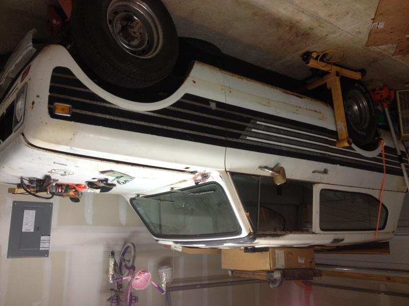

I spent the next 2 months tracking down owner to get a title put into my name (was sold with no title). After that I started hunting down forums and info to figure out what I can to it. I found the top on craigslist in austin and bought it for another 200 bucks. The lift gate is rusted pretty bad and po did a crappy weld job trying to get hinges on.

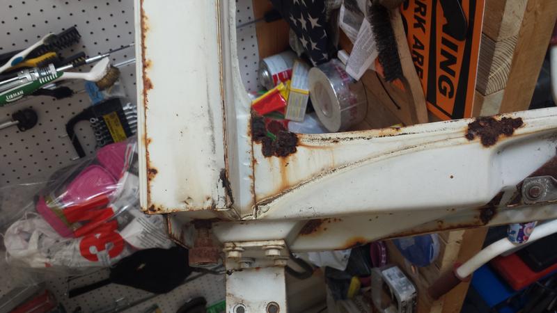

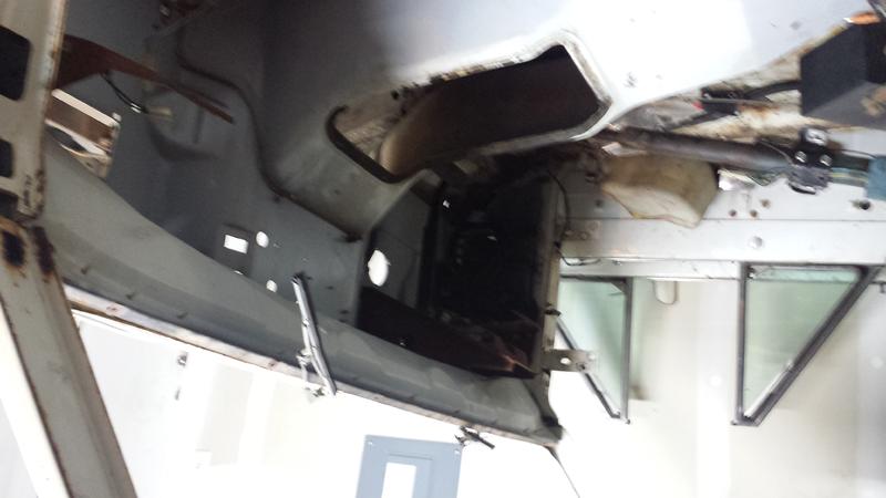

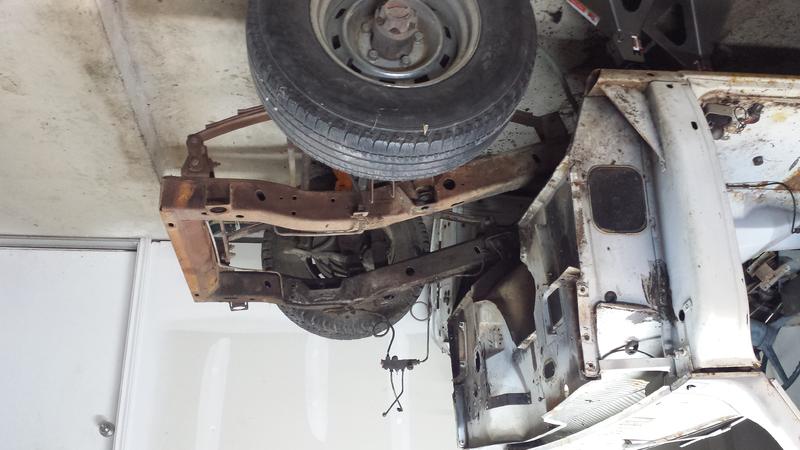

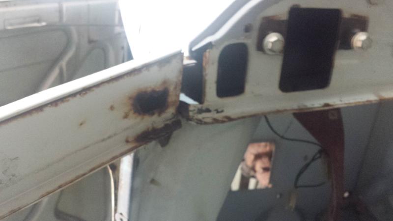

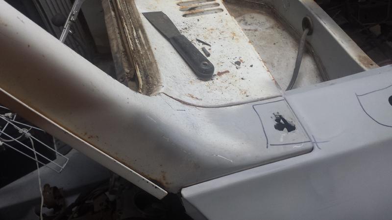

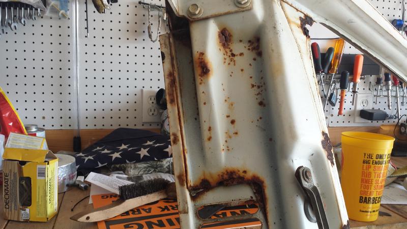

It was actually cheaper to sell the 345 and change up to Chevy 5.3/ 4l60/np241. I first tried IH Parts America for kit but they were still working on Scoutco kit and had no reviews of it at the time. So, I went with another company's kit, it should be here Monday so I will keep this up to date with pics and my opinion of it. I also ordered reverse shackle kit and new spring perches from here which get here Monday as well. Here's some pics just because everyone loves pics. Gotta love the rusty windshield frame:icon_stressed:

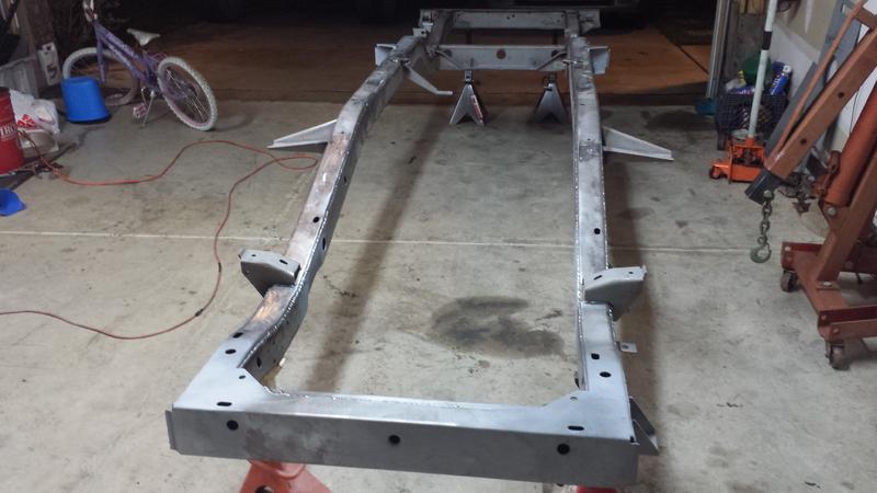

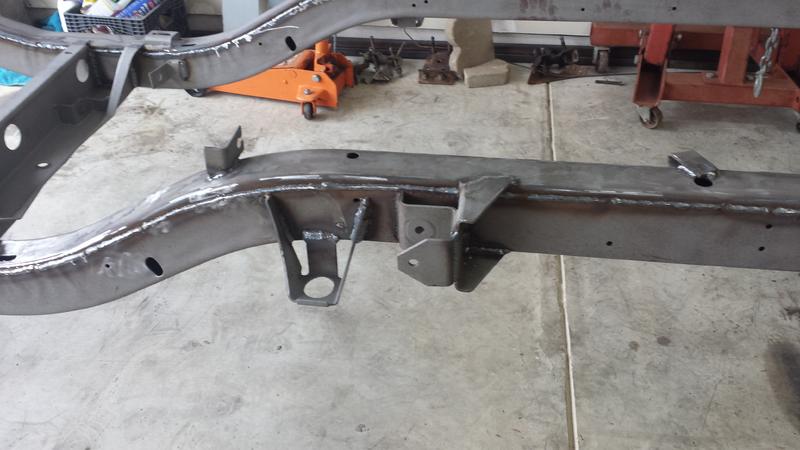

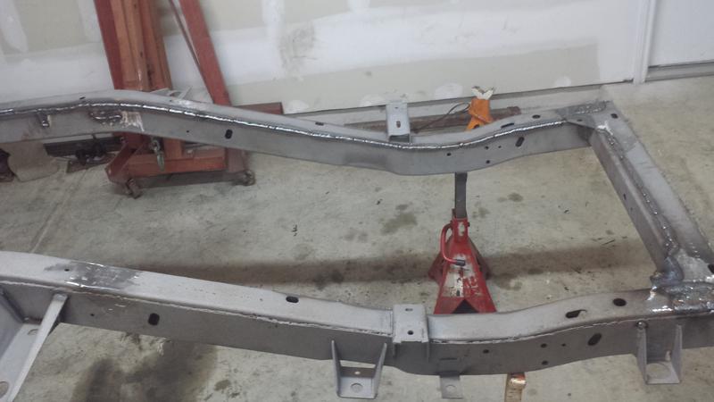

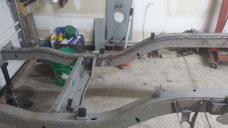

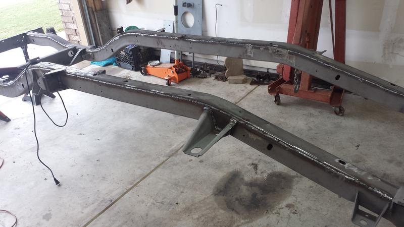

Here's pics of the frame sandbasted and completly welded from end to end. They must have out new guys on the welder when they made these frames all the ones I have seen look like a 8th grade welding class did the work.

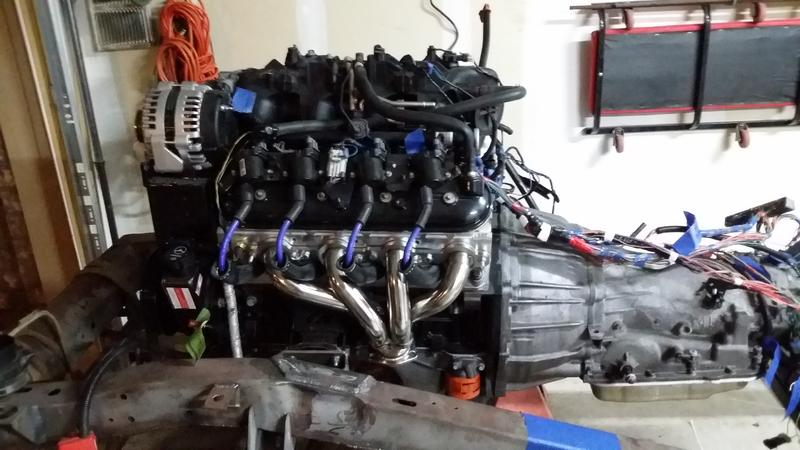

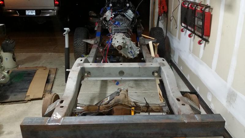

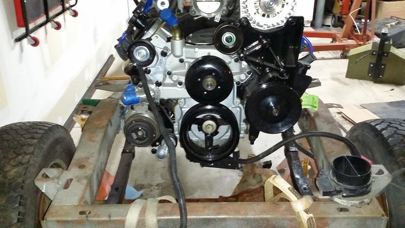

Well it's been a while so time for more updates....
Motor was rebuilt, had some parts powdercoated on it.

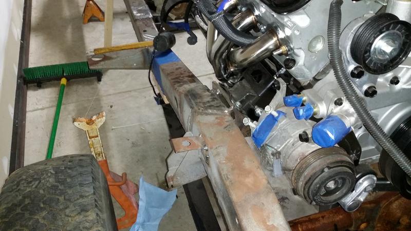

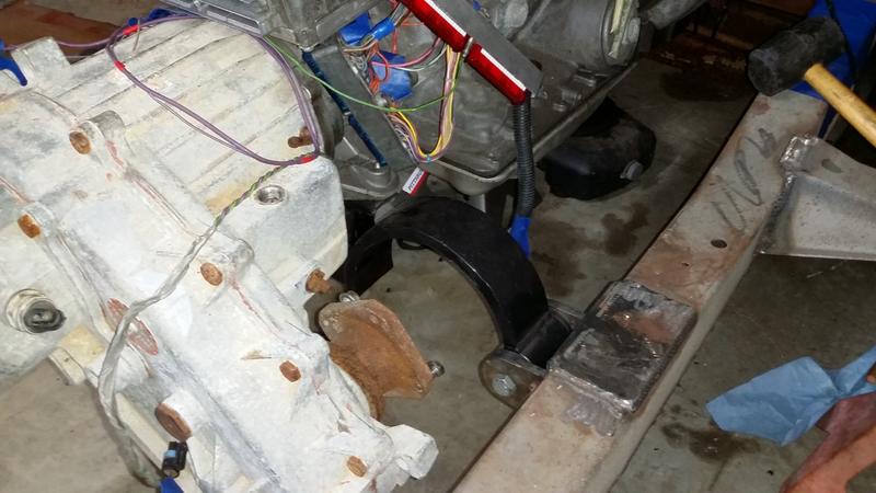

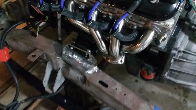

Got motor mounts and crossmember welded in. It took a while to get the harness thinned out and wired up but, it started up yesterday so, I guess I didn't screw that up.:smile5: I got the reverse shackle almost complete need the frame drilled still. Transmission and transfer case still need to be rebuilt, when I got the transfer case I picked it up and water poured out of it so I might be screwed on replacing internals but I have a spare drivers drop to swap internals into it.
