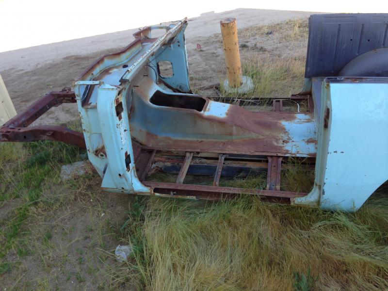

I am working on taking the body off right now because there is a lot of rust and I have another tub to replace it. I am hiring someone to do the body and paint (tub I have has floor boards and rockers cut out but includes the replacing sheet metal) . I figured I would do the work on the engine, transmission, and suspension.

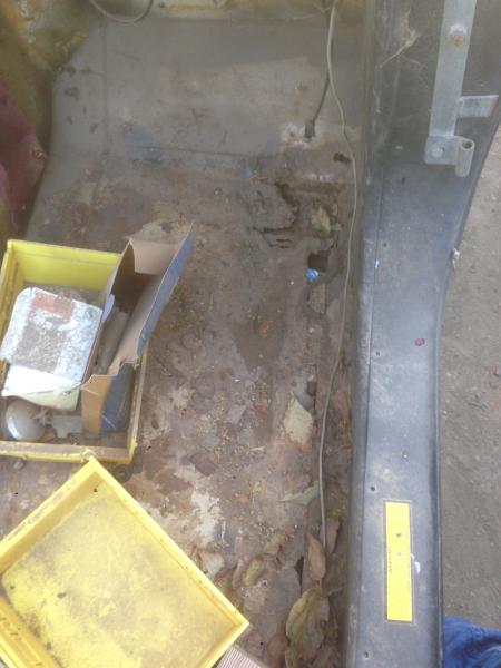

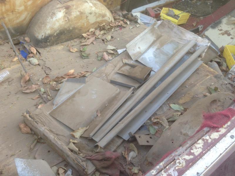

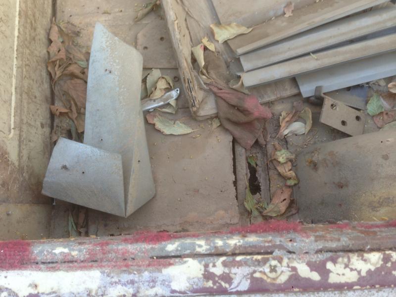

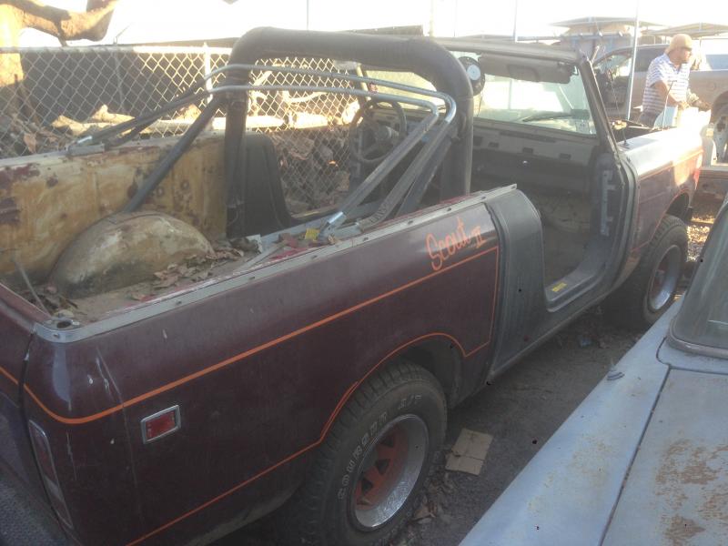

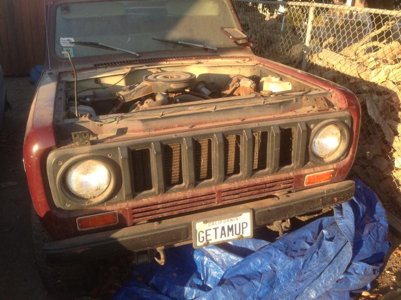

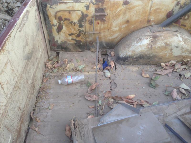

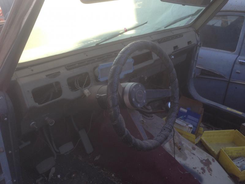

Here are those pics I promised:

Ouch. You got bit by a po virus. For the front floor board and body mount sheet metal under the front seats, IHPA has new replacement sheet metal parts listed in their online store. They May even have a replacement for the rear bed area. I replaced the rear floor in my 73 beast, with a sheet of 11 gauge flat plate.

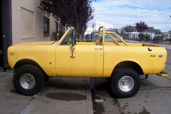

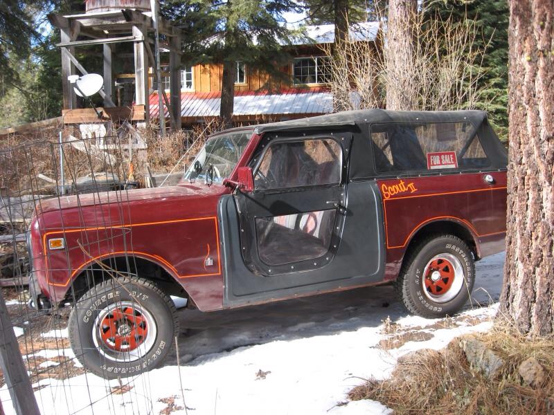

Here's a snap shot of my 72 ole yeller rolling on 33" shoes, 1-1/2 body lift, and what appears to be 2" lift springs. Hopefully this will give ya an idea of how your Scout would sit on 33" tires
Nice looking Scout. Im going to go with 33s. And yes I bought another tub with that sheet metal. It has the floor boards cut out and rockers (where previous rust was) and the rest of it is fine. There are some spots that are going to require some extra work. I need to get a better picture of the tub.

Another question: has anyone ever taken a Jeep seat bracket and installed it in their Scout? I personally dont like the Scout seat brackets.
Not sure if that would work. Floor in the Scout angles down from trans tunnel to the door and I think the jeeps floor is flat. Fabing up brackets for the seat base isn't that difficult. I made up my own for my 74 and as I recall, IHPA posted up a photo somewhere of a seat base they made in one of their build threads.
