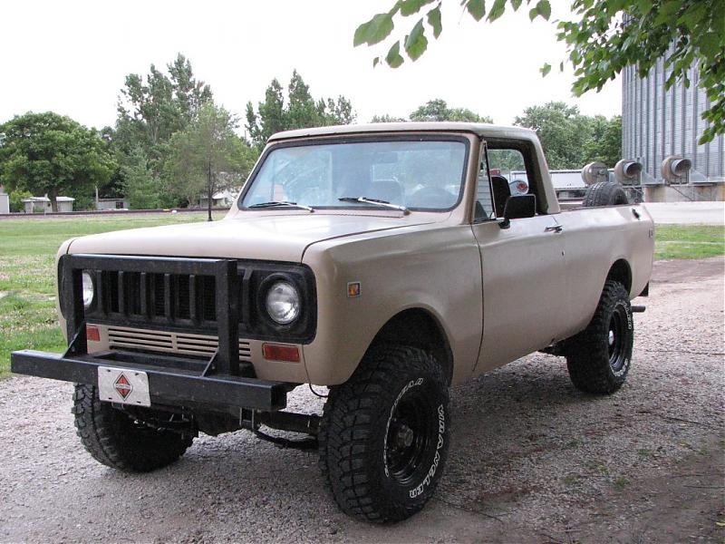

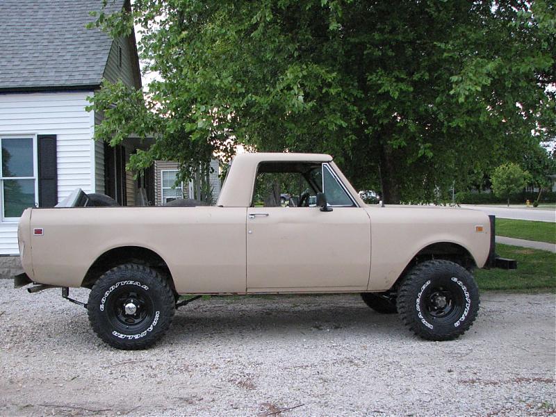

Here is my terra with:
Rough Country 4" springs
5" shackle kit
4 deg caster shims
Bilstein 5100's
stainless extended brake hoses
15x8 cragar v-5 black steel wheels
32x11.5 goodyear wrangler mt/r kevlar tires
all in all, im loving the setup. The ride is not bad at all. Not bad enough to complain about anyways. Install was a lot easier than I expected althought I did run into a few problems. I had to grind the heads down on the center pins to get them to fit into the holes on the axles. No big deal.
Id like to give a thanks again to Jeff at ihonlynorth for going out of his way to make sure things went smoothly for me. Hes one hell of a stand up guy. Thanks Jeff!
