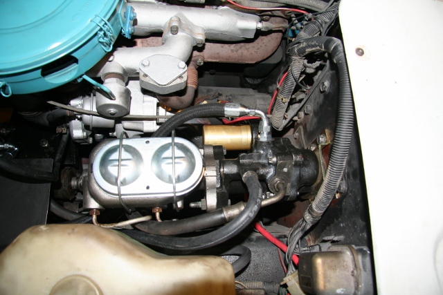

I just put a hydro-boost setup in mine. Best thing I ever did. Stops like it has real power breaks.
