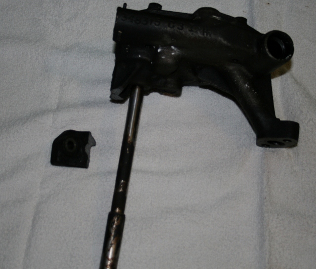

Thanks to michael & dealbreaker. This in of the last IH 200 3/4 ton pickups made. It is 2 wheel drive with a 345 and a rear sump oil pan that must be like in a Scout II. It is being worked on in a local community college with the instructors being a IH mechanic and his Dad has been an IH mechanic for 25 to 30 years, but during the reassembly of the engine the oil pump casting was broken, the single hole tab was broken off and I can't find a new one. Could this pickup, being on of the last ones built, have a Scout II engine in it ? This oil pump is a lower profile unit to fit in the front of the pan. Thanks for the help!!
Please post a picture of the oil pump assembly that is needed clearly showing the pickup port location. Then we can make a better judgement regarding which one you need.
That picture does not "clearly" Mark pick up tube location. Pick up tube location is on top of that pump as pictured. Bottom of pump installed in engine.
That said it look differant then the oil pump I have out of a 72 IH 345 pick up truck motor. Hth :thumbsup:
Eagle-Mark: the pump is on it's side. The hole to the top of the photo is where the pickup tube goes that has a 90 degree bend and goes to the rear of the engine, very different than any pump that I can find. I found a welding shop that would try to braze the tab back on. I hope that that works! This pickup was my dads and has been setting for about 10 years or so. Thanks again

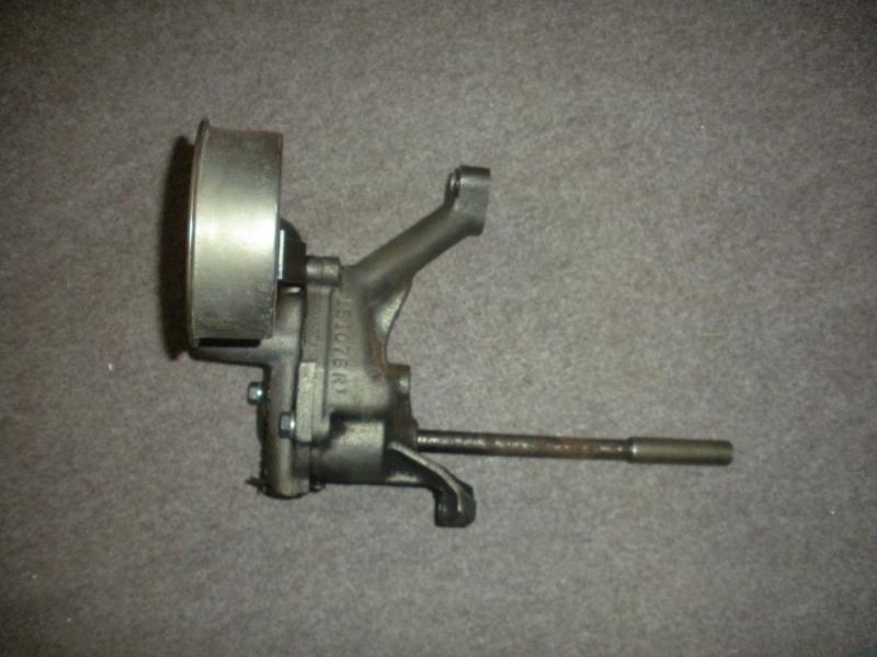

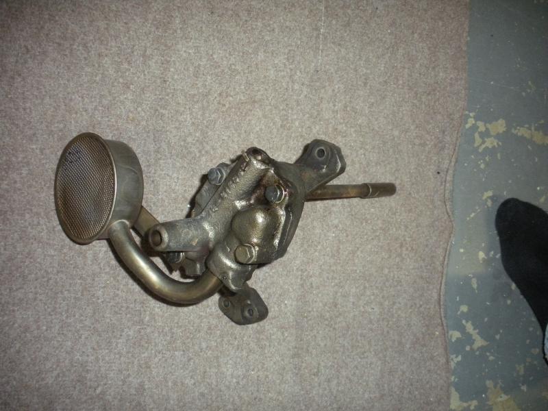

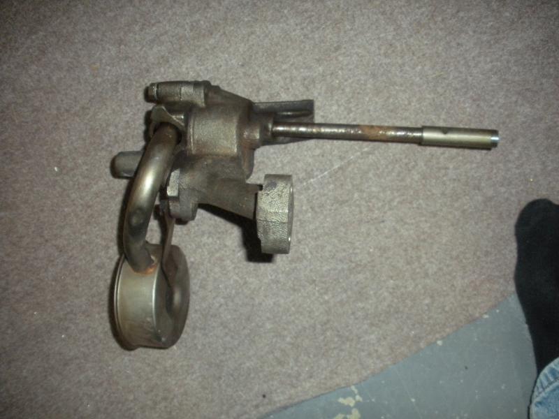

If you have some more pictures of it from different angles, I might have one in my basement. Came out of a 392 in a 72 Travelall.
Steve
Ornelles and others: thanls for the pics, but that is the wrong pump, I have ordered two of those ( I made surwe that I couldsenfd them back!) and that leg on the bottom hold the oil pan away from the block about 2" and the pick tube assembly is about 10" to short. Appently the '75 345 is rare bird indeed. Thants for the help, I have all ready put in new main and rod bearings, had the crank polished and the heads reworked and planed and new rings and then this happens!!
