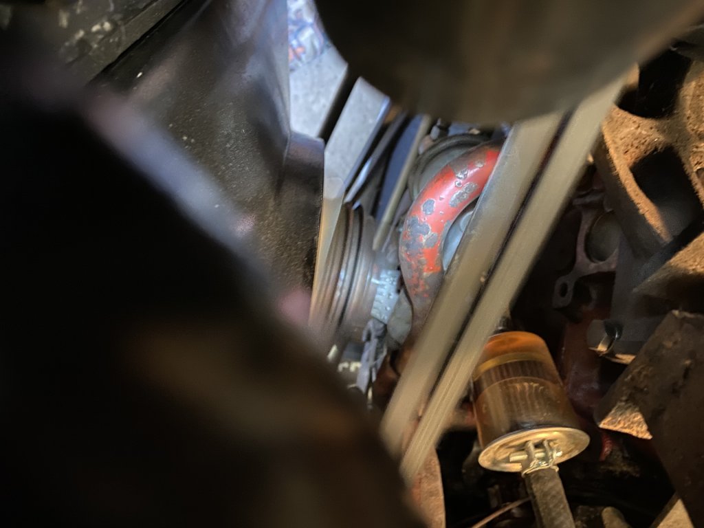

I finally decided to check the timing on the S2
It’s a 74 345 auto 2210 carb
Just rebuilt carb a couple weeks ago
Still not running great
About 20” vacuum at idle around 800 rpm
Checked timing on #8 cylinder it is running high between 18-20 at idle
Dwell 28*
When I try to lower it the vacuum advance hits the bracket or valve cover
That’s turning it clockwise.
I am thinking I need to re stab the distributor ???

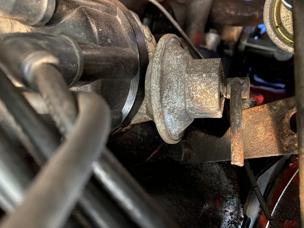

I ended up removing the A/C bracket that the vacuum advance was hitting, it then allowed me to turn the distributer more, it seems to run the best around 10*, but stalls out every time I put it in gear, the rpms drop right off.

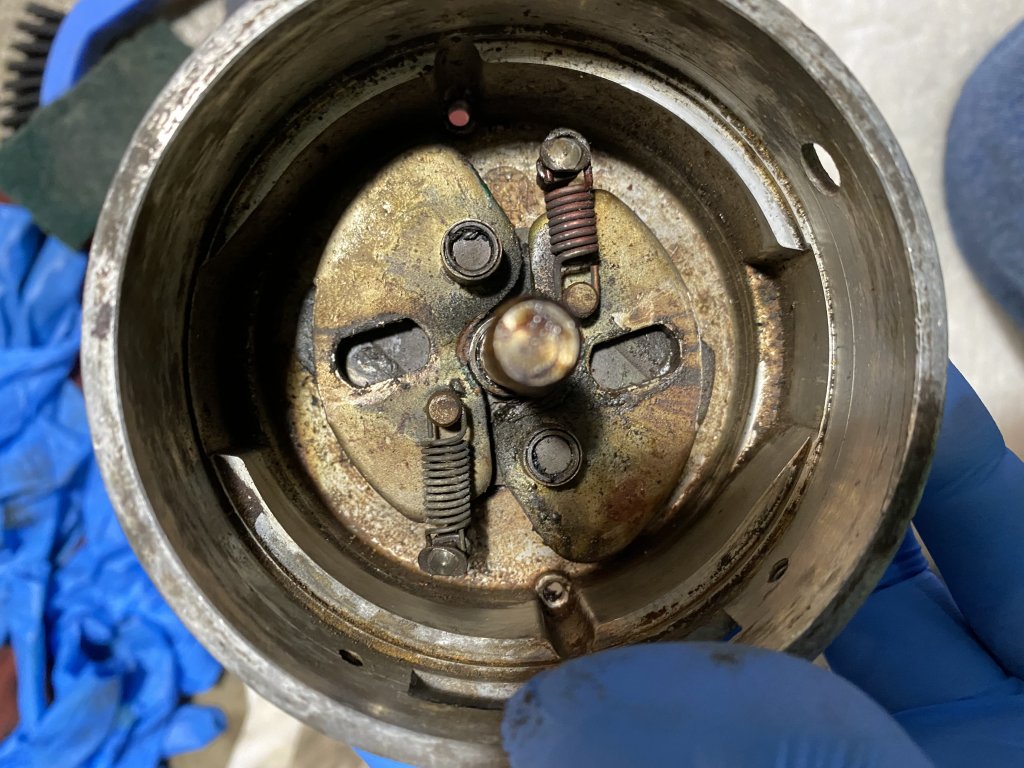

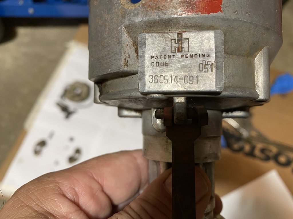

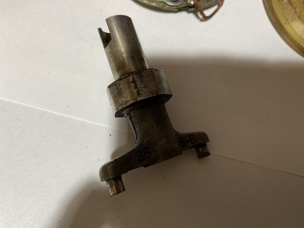

I finally got around to removing the distributor, there are some parts worn.
I had .029 end play on the drive gear, manual says .035-.040. seems ok to me, I removed the roll pin, gear will not come off. I think I will leave it.
Vacuum advance bad. I couldn't find one, had it rebuilt.
The slide blocks on the Cam are gone, little pieces inside housing.
The Thrust washers under the advance plates are brittle.
Lots of dirt.
Are there parts available for this distributor ?
