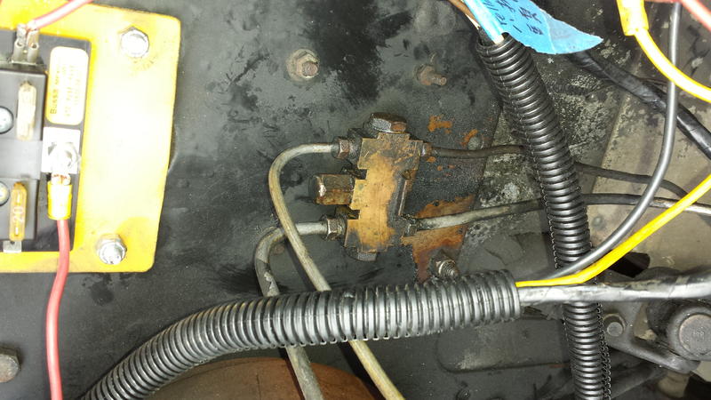

74 international brake balancing valve
hongmlam

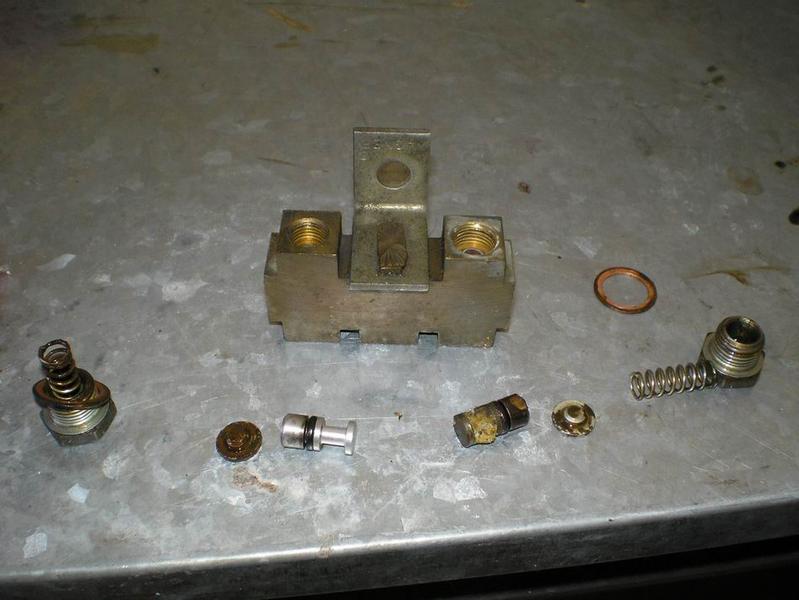

Fyi, those are easily rebuilt with two o-rings and two copper washers. Easy to rebuild if you remove it from the vehicle.
New valves of that type are not available as far as I have found in my searches, so I rebuilt mine. Be sure to take note of the parts as they come out so you put it back together correctly. Also, remove the brake warning switch first and re-install it last.
You May be able to locate a used valve from someone parting out an IH pick-up truck/Travelall/Scout with 4-wheel drum brakes, but you would need to rebuild it before using it.
