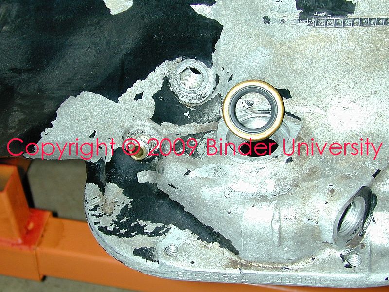

So let's try and id exactly which tranny ya got. On the pan rail just below the shift lever you should find a string of stamped number and letters. Inna true chrysler app, that number will most likely be the original donor vehicle vin, if it's a service part tranny, then it "might" have had the vin re-stamped into the case. No matter...see if ya can read and then post that string of numbers exactly as you see it. A nice phot would be even better!
Pic I've attached shows the location. This 727 is a very early unit.
Ihc versions of the tf 727 (code t-407) normally have the service part number or the oem part number stamped in the pan rail, not the vin.
