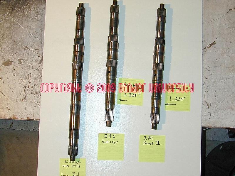

This shot compares the actual output shafts in the same order of the cases shown in the other pic...quite differnt!
The dodge takes a bolt-on yoke as does the IH fullsize unit in the middle. The Scout II on the right takes a 23 spline "bull gear" in order to mate with the married d20 transfer case.

Mike, that picture of the dodge tranny...you cant swap out the parts to make a married 205 could you??? Those pics you showed of the shafts, I know the dodge is longer, but could the shaft out out of that dodge tranny you refered me to could it work in a IH tranny, along with the 205 adapter, or totally different bolt pattern? I think I need to get into the tranny business...
I can't say for sure if what you propose would work steve...but when I conjured on this same concept while working with terry's tranny package I did spend some time in deep thought (and some parts interchange research) about this same thing!
On the surface, I really see no reason why it would not. The mating "pattern" on the rear of the 727 cases are all the same for the various tailhousings or transfer case adapters.
The dodge 727 with the married 205 is near identical internally to what you have right now (it does have the partial throttle kickdown valve body and associated input shaft same as the later Scout II).
So... (I know where you are going!) it might be possible to put all the dodge guts (or whatever is different) inside your existing IH-pattern 727, and convert it to a married 205 (dodge version). With that, ya can install the appropriate gearvendor setup.

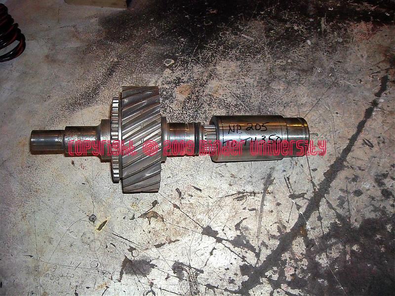

But...here's a shot of a GM th350-spec'd input shaft for a married 205, I have no idea what m/y combo this came from, just parts on my shelves! You can see that the input shaft is massive and so is the coupler which is "sealed" to the shaft when it's slid home over the "o" ring on the shaft.
I also have a Jeep 727/d300 output shaft here now that is going into a 727 for a club member so he can install a d300 in his sii. But I don't have his actual 727/300 coupler or tc adapter/tail housing as he forgot to put 'em in the box with his other parts.
The 205 input shaft in that pic is noticably larger in all dimensions as compared to similar, but much lighter-duty 727-to-d300 stuff.
I'm not knowledgeable about which m/y dodge 727/205 packages to look for, but anything that is a 727 which was pulled from a diesel I'd have to say would be suitable.
