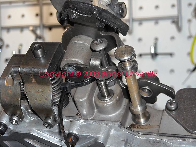

Ok, I popped over here from bp, hoping to maybe find an answer to an issue I've got with a 727 in my '79 Scout II (345). I'm about to swap a good used 727 into my rig, but noticed the throttle pressure shaft seemed to be freefloating. It turns a full 360 degrees. I don't think that is right, and wondered if anyone had any thoughts as to what might have come loose.
Do you mean the throttle pressure control shaft to which the lever is connected simply swivels back and forth and stays in any position you place it?
If so...then it's most likely that the spool valve is stuck in it's bore...that creates a "max" line pressure situation which is not good for the trans and of course inhibits normal shifting. If the valve is stuck, then the internals of the valve body are trashy, it will need to be dismantled and completely serviced/cleaned.
Second most likely, the actuator for the spool valve has broken loose from the pivot rod, it's a welded assembly.
Either way...simply drop the pan and take a look! It's about the simplest thing you can do.
This pic is a closeup of the area of concern. On the right side is the manual shift valve which connects to the shift selector. The throttle pressure valve can be seen to the left of the manual shift valve. In that shot it is in the "minimum" position (throttle closed). As the throttle opens, that valve is depressed against it's internal spring in a linear fashion.
Disregard the tie wrap...I place a tie wrap over the throttle pressure control/shift control before removing a valve body from a trans so that the control does not "jump" out allowing the detent spring and ball for the manual shift assembly (rooster comb) to fly across the shop.

Thanks for the quick response Mike.
The shaft itself, and therefore the arm if it is attached swivel and remain anywhere I put it. There is absolutely no friction, or resistance whatsoever.
Ok, I'll drop the pan and have a look see. Thanks for the pictures that is a huge help. I figger I best get a hold of the munroe book. Damn, I was hoping this would be an easy swap. :mad5:

Alright, I finally got back to that 727 I was talking about. Got it up off the floor and threw it on an engine stand to make it easier on me. Dropped the pan and found the problem. The bottom of that shaft has an arm on it that actuates the actual throttle pressure valve. Well, the arm on the end of that shaft was sheared off, also, the long black adjuster bolt was also bent. Looks an awful lot like the top of that shaft took a hit from something hard enough to drive it down into that adjuster, bend it, and shear the arm off. I grabbed the valve body out of the other trans and swapped it, plus the shaft and arm. Adjust the bands and closed it up. The other thing I noticed is this trans must be from an older model than my '79 as it has the bigger torque converter, since I ain't got the matching flex plate, I'll swap the converter from a donor. I snapped some pics but forgot to download them. Hopefully my saga with this trans has come to an end. Thanks for all the help Mike.
