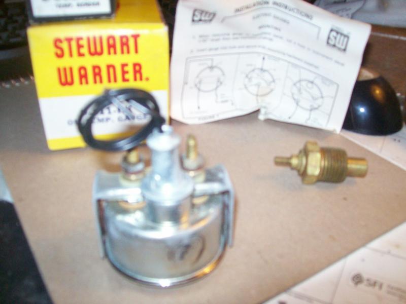

I have these gauges and I have also red warning light's listed in the " for sale ad's "...Jeff
