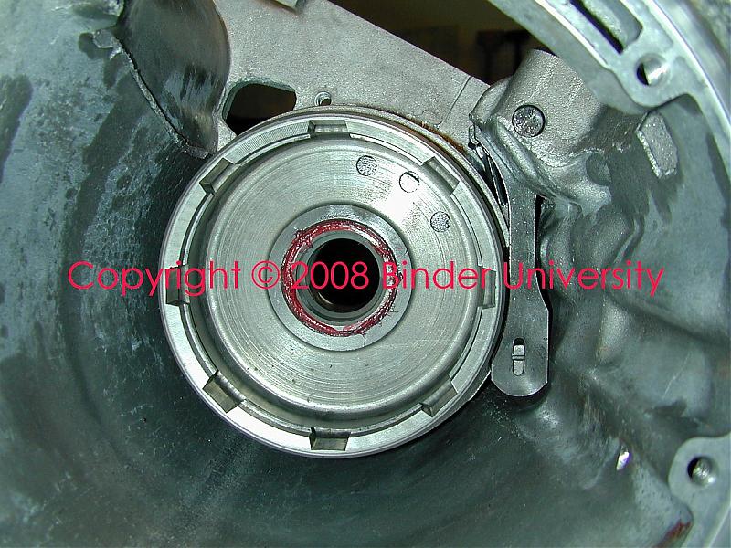

Well good news, the band isn't broken. The strut broke and the servo snap ring came out but the servo stayed in so the servo and bore look to be fine. Now I need to find a good exploded view so I can make sure to get it all back together correctly.:yesnod:
Ok I found this picture in another thread here which tells me basically where the parts go. Now I can move my band around with my finger so it isn't attached at the other end away from the strut. Does the band just rest against this assembly or is it possibly broken too? Could I just rotate the band up against this end and install a new strut then adjust? Could it be this easy or is this just wishfull thinking on my part?:icon_confused:
I'm sooooooooo happy that the band isn't broken so please don't shatter my new found joy!:ciappa:

The servo apply strut and piston left the scene due to excessive band clearance (meaning the band was nowhere near adjusted properly). That also means that the band is worn out and is lacking friction material. It is aggravated by banging the shifter back and forth forward/reverse/forward as in "rocking" to unstick a stuck rig and excessive engine rpm when doing so.
If the servo piston popped the retaining ring, then a tremendous force was exerted and I can't believe the retaining ring groove in the case bore is not distorted. No way I'd put that trans back together without using an aftermarket stabilized servo piston, it will do it again now as the bore is distorted.
If the low/reverse band is gone, then all friction materials in the kickdown band and both clutch packs are gone. If you don't perform a complete overhaul at this point, you are simply wasting time, oil, and risking damage to some irreplaceable parts.
Installing a replacement band in the case after the servo has been rebuilt can be real tedious in a bench build. I use forceps to install the strut in a precise location once all the other parts are positioned. Since the pic you posted is mine...I can assure you that even taking a picture that shows the strut/band/anchor detail is near impossible.

installing a replacement band in the case after the servo has been rebuilt can be real tedious in a bench build. I use forceps to install the strut in a precise location once all the other parts are positioned. .
But I'm not replacing the band....when I put the art carr valve body in I had this stuff apart but I don't remember the specific assembly. My only concern is the band attachment to the "strut" or whatever it's called at the other end. Using forceps sounds like a good idea though, thanks.
since the pic you posted is mine...I can assure you that even taking a picture that shows the strut/band/anchor detail is near impossible.
I did say the picture was from this site. Do you want me to delete it from my post?...I'm not looking for a picture of it but a expanded view of the assembly so I know I put it together right.

These parts very well could be worn but we can't know for sure without tearing it down further which isn't going to happen right now if I can help it.....from what I see in taking it apart this was all caused when the strut broke. When the strut broke the servo unrestricted slammed down against the spring which popped the snap ring out. Fortunately as this happened the servo didn't "flip" but it must have cocked very slightly which let the servo unseal and that's where it stopped. When I took the servo out the seal lip was folded over in one section. It May or May not have been out of adjustment but the strut is for sure in two pieces.....I'll get it all put back together and I'll keep you guys posted on how it holds up.
