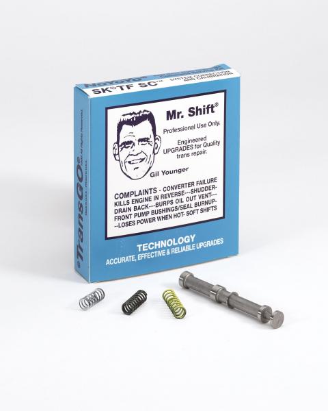

Ok ,m/m, after further investigation the transgo kit I installed was the sktfsc torqueflite shift kit, not the tf1.
There are possibly 2 issues I can forsee. The adjustment of the manual valve being to far in the partition or the adjustment of the pr valve which could be too loose. Not sure.I made no other mods to ths trans other than venting the cases and resealing. Spoke with a guy on the mopar forum and he suggested turning the pr valve adjustment in 3 turns to give it more pressure at the initial engage and during shifts any thoughts on this? Thanks in advance. Brad
The "sk® tfsc" is not a shift kit nor is it a shift reprogramming system. It is what was once referred to as the "no yo-yo" solution for a few specific potential problems that "some" 904 and 727 transmissions might develop. In other words, a fix for specific issues that the manufacturer never did address until several years after the fact, this is typical in the autotrans industry and most especially for any autotrans manufactured by the GM/hydramatic division.
In actuality, by the time ihc began using the 727, those issues had been corrected and only crop up after a rebuild when incorrect parts were installed instead of the updated stuff.
I don't mess with that repair part since it's not needed on the units I build which involve only the tf-2 or tf-3 shift reprogramming kits or the B&M equivalent of same. Therefore, I don't have the instructions for those.
As far as installing the replacement manual valve in that sk® tfsc kit, that is a no brainer, and none of that install involved separating the valve body as the other system do. If you installed the correct spring for your application, and then you adjusted the spring limits correctly, you will have a functional system that is completely benign in operation. In other words, it does nothing for enhancing or beefing the shift characteristics.
And when installing that transgo valve, you must set the spring stop exactly to the specification given, I totally disagree with what your other advice is regarding diddling control pressures as that is simply not possible unless you have a gauge set connected and fully understand what the ramifications of diddling will entail!
If it worked fine before doing the spring change (the replacement manual valve is not creating this issue, it can't!), then that is the problem, something was not adjusted by the instructions supplied with the parts.
I'd put it back like it was in the beginning. Then if you want to improve the overall performance of the slushbox, do the job right and install a full tf-2 shift reprogramming system.
