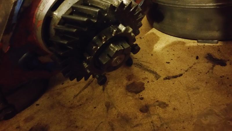

Is there a secret to removing the bolt from the end gears of the transmission? I can not get it loose.
An air impact gun should pull that right off. If anything a couple foot extension on a 1/2" ratchet(or better yet a breaker bar) should break it free. Make sure the transmission is in park.
Agreed, an impact has always worked for me, while it's in park as Jeff mentioned. I think once, maybe twice, I have used an extension pipe on a breaker bar that worked too
