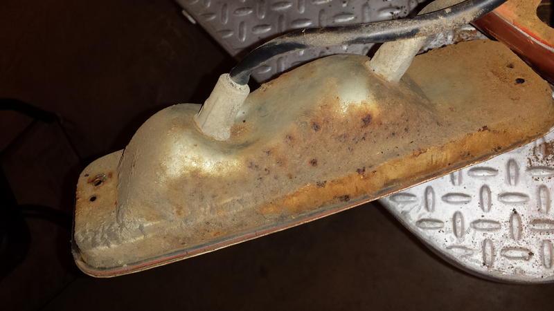

What is the best way to disconnect the wires from the harness to the back of the tail light housing..
There is a plug, possibly inside the frame on the right behind the bumper bracket. Once disconnected you'll be able to remove both lights as complete assemblies.
