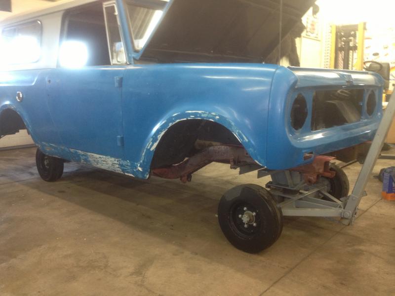

First up the victim rust free 67 800 travel top. Sorry if this is moving to quick this is a three week build. First picture the Scout showed up and about an hour later the body is on the paint dolly. :d

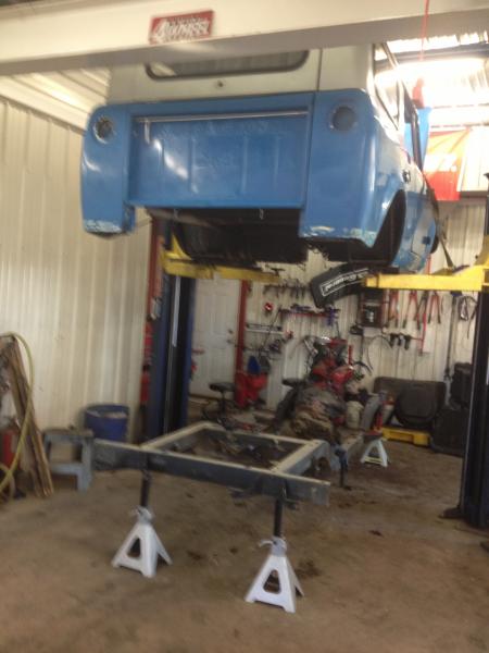

Here you see the body off and the frame with the axles removed.

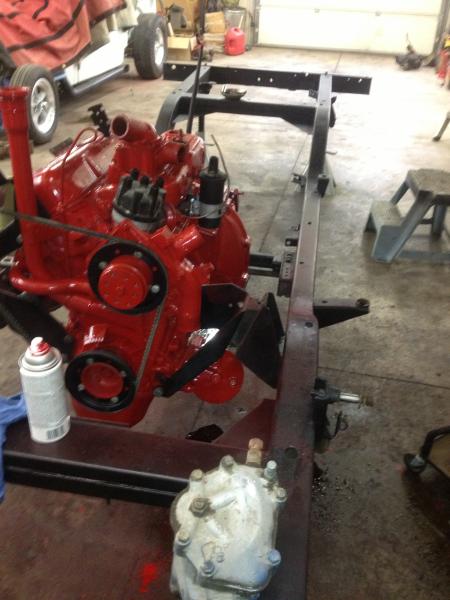

On this Scout we verified the 152 was rebuilt (good compression, clean under the oil pan and valve cover) ran very good also. So we started the steam cleaning and painting on the engine and chassis.

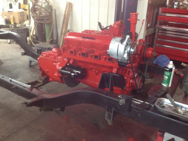

Here's a look at the chassis all painted, engine with new starter, alt, fuel pump, water pump, cap and tune up.

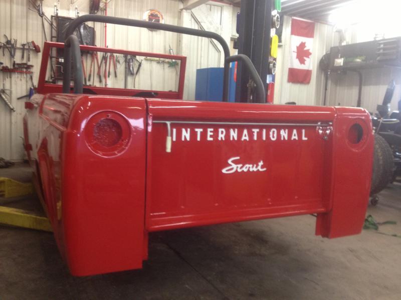

Well the Scout is back from paint ( time flies in a computer world :icon_biggrin: )

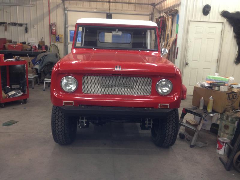

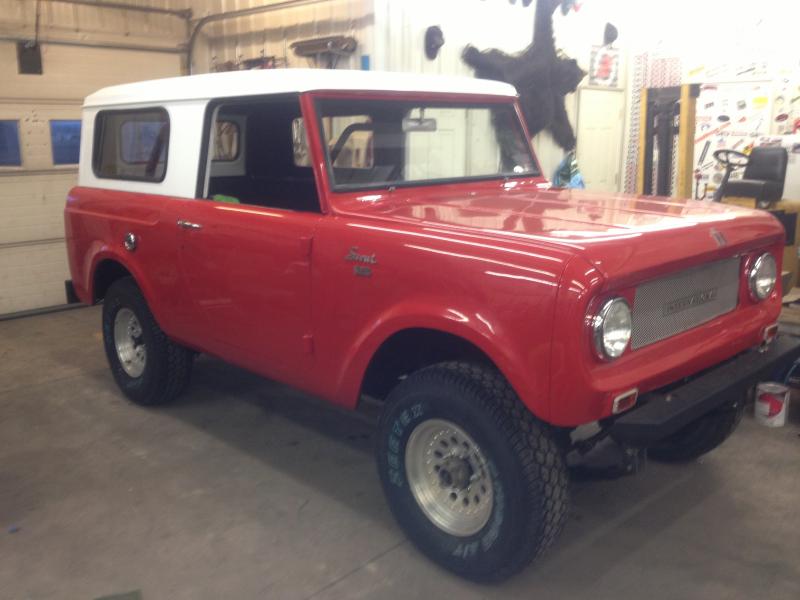

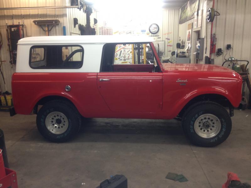

I have had the Scout back from paint for about three days and just finished the wiring. Hoping to get it over for an exhaust system tomorrow, then over to a friends place where he will tint the windows and install clear stone guard protection. Here's a look today the paint looks great, you can see the lift from IHPA looks great, I had the aluminum wheels laying around and the 31s fit the Scout spot on.

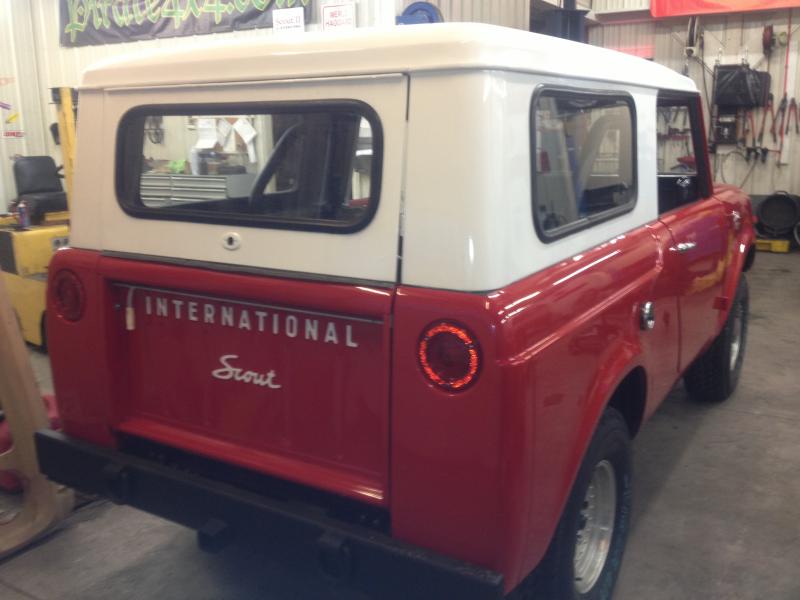

Rear view we spent about two hours building a rear bumper, the one that was on the Scout was junk.

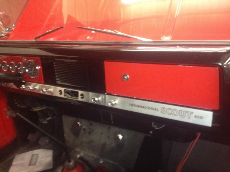

I had the dash powder coated, and the panels painted to match the body color. I am looking around to find a radio that will fit the dash but here's a look.

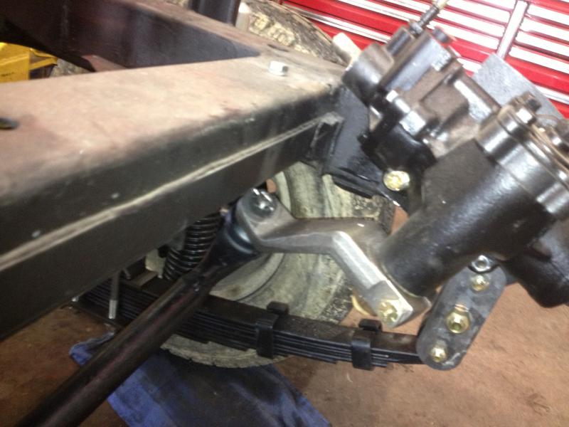

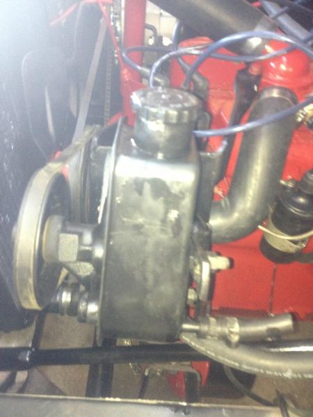

I used a 2000 Chevy half ton steering box and this bracket gary billings makes. Here you get a look at the set up. I have chatted with Jeff and gary about this, I am thinking Jeff will start caring this bracket, the one for a 152 is different than a 196, so be sure to let them know if you order one. Also be aware you need the pump and three bolt pump mount from a Scout II.

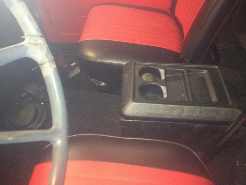

Here's a shot of the carpet and a sneak peek at the seats. Kit is still working on the door panels and side panels. He will also be doing a headliner line the ones in the doll up scouts. It will be the same red and black vinyl material. You can also see I used a Scout II console with the cup holder.
