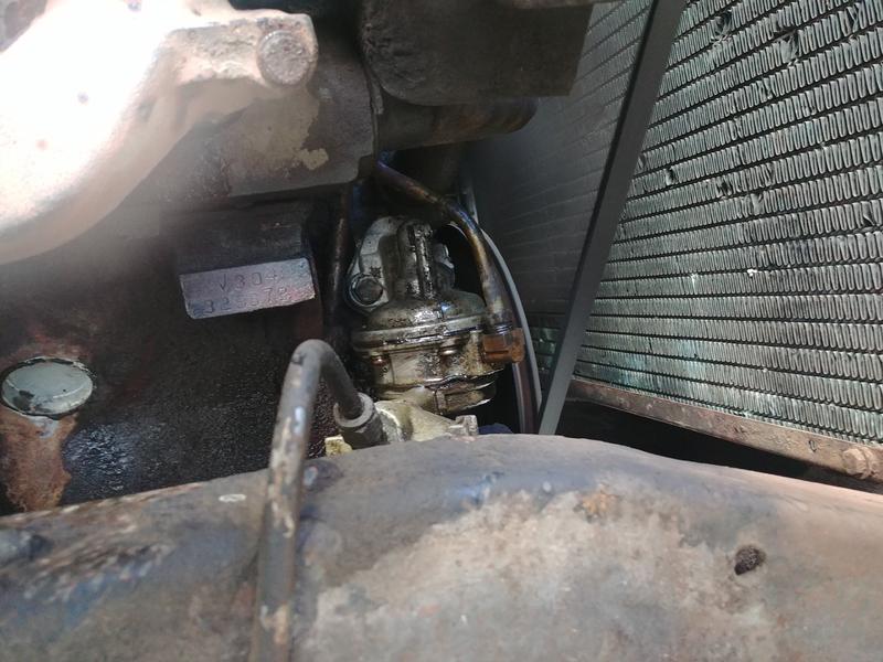

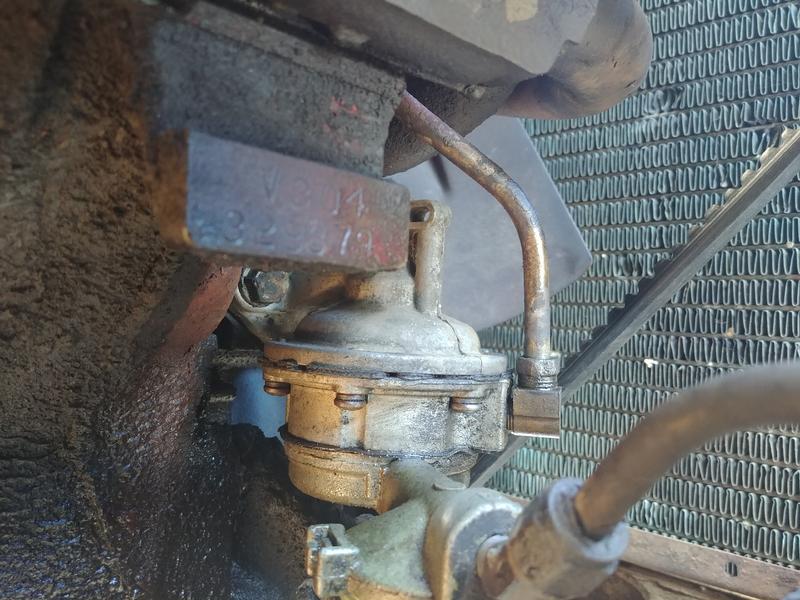

Howdy again, these may not give a complete view but my fuel pump just bit the dust so I have em. Here are a couple angles from down on the pump:
attachment.php
attachment.php

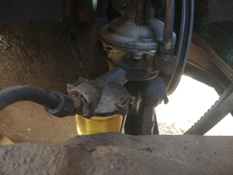

Here you can see the top of it, starting at the fuel filter near the end of the upper rad pipe(should look a bit diferent from yours) and over to the carb. I dont think the filter is original but I could be wrong:
attachment.php
