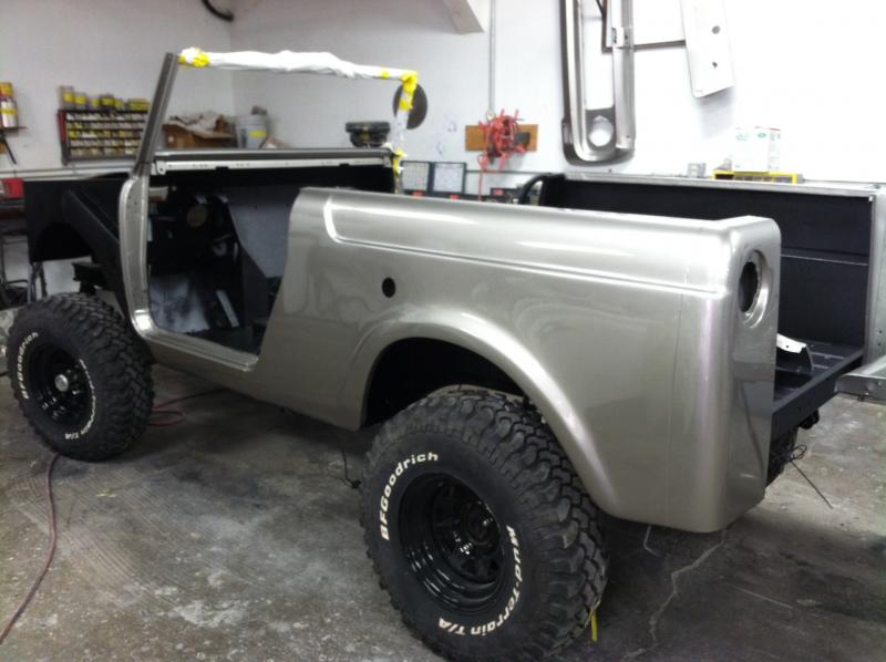

Wanted to get a few pictures of my build for y'all to see.
This is a 64 Scout 80 with narrowed d44 axles with a SOA conversion. I did a frame off resto to this rig. Powder coated the frame and rhino lined the inside of all the fenders and underbody. We decided to put a fully rebuilt and blueprinted 196 ci motor coupled to a t18 tranny out of an 800 donor rig. I am working on getting the motor painted and installing a painless wiring harness now. Will get more pics up when this gets closer to being finished.
Thanks to hi only north for all the help and parts along the way.
