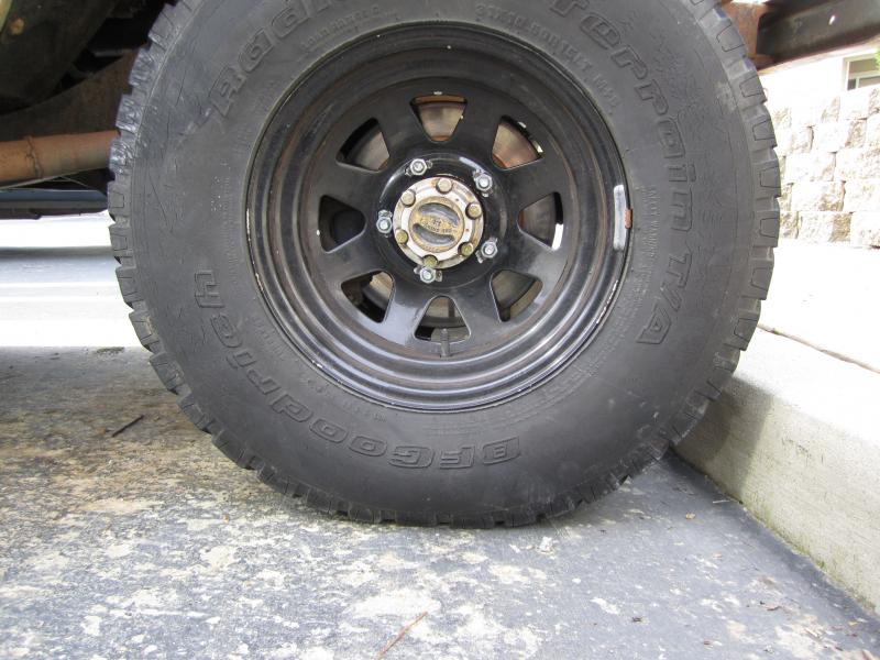

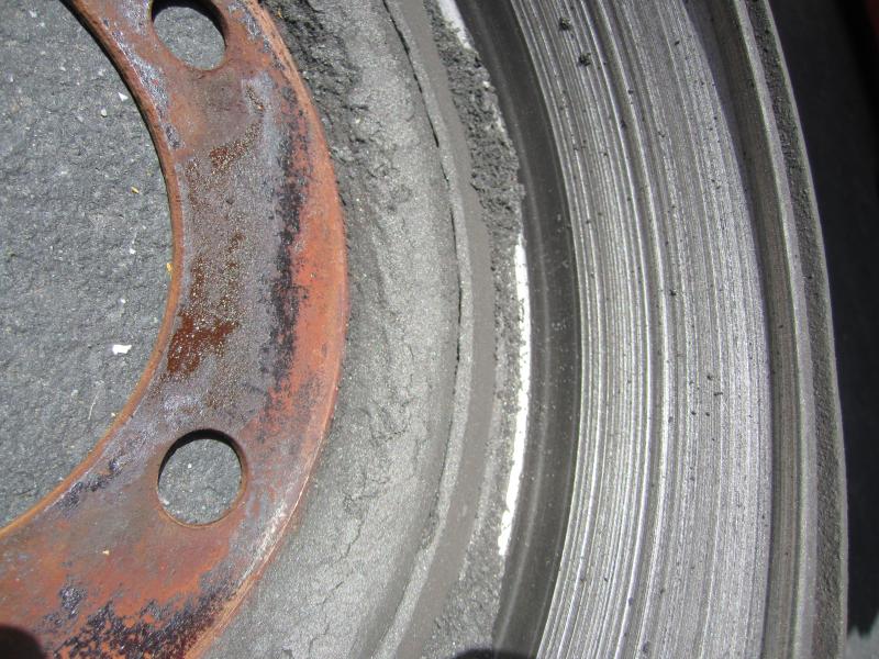

4/18/11 - this is one of the many upgrades I planned to do to this Scout over time and the shoes running themselves into the drum was more than enough motivation to initiate the front disc brake upgrade... Gonna be sharing info and pictures as I go.... The job began yesterday fyi....

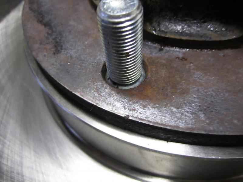

1977 cj7 rotors.. About 35 bucks each at the local parts store. The studs are dorman part number 610-174 and the shoulder profile of the new stud is a perfect fit into the new rotor and old hub... Different hole size in each....
Say goodbye to those left hand threads ... :thumbsup:

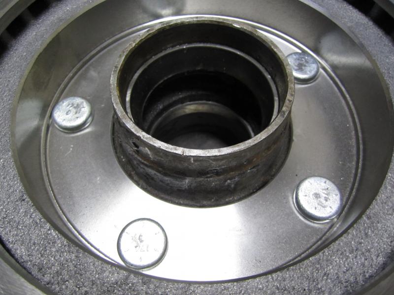

4/19/11 -- got it all back together -- took her for a test drive, and it worked like a charm. :thumbsup:
I was pleasantly surprised that the original master worked with the new Chevy calipers so I didn't have to get into changing that out just yet... The pedal engages at about 2".... So that means there is plenty of volume to feed the disc calipers and this little 63 Scout model 80 stops damn near on a dime with no pulling or fading whatsoever.
I plan to change the master down the line with a dual circuit master. Probably from a later Scout so I don't have to cut and fab the fender well for fitment. Going to disc on the rear as well once the new Ford 9" I am building is complete.... :winky:
end note - this was a total bolt on upgrade that cost me well under $200. The only real fab and hardware changes I needed to make were clearancing the backside of the knuckle for caliper clearance (easy cheesy), changed the 1/2 plug on the back of the knuckle to a recess type so as to clear the caliper, new brake lines that went from the existing hard lines to the caliper (banjo fitting), and slightly longer grade "8" bolts for fastening the new backing plates and spindle to the knuckle....
