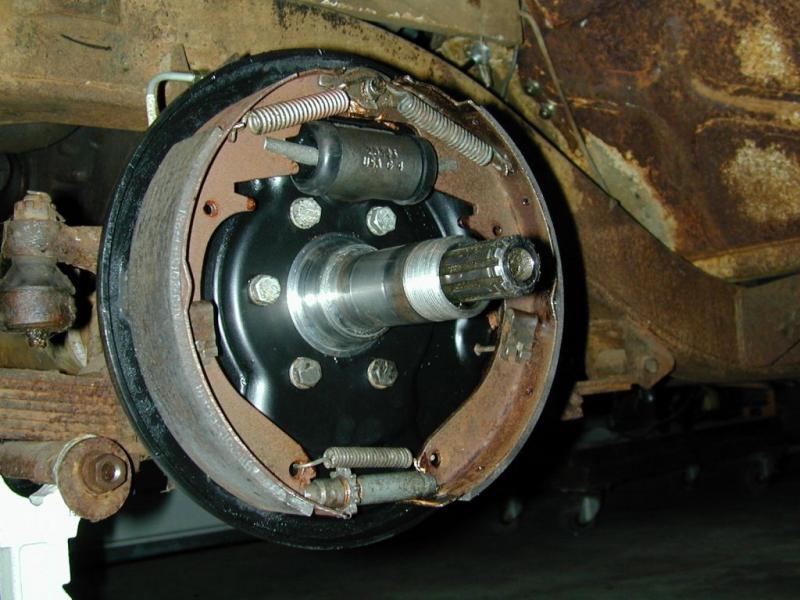

This a typical 10" lockheed front brake set after freshening. This one has bonded shoes since I had a set of nos on the shelf. That is not rust on the shoe foundations, that is the resin used to glue the lining material to the shoe table.

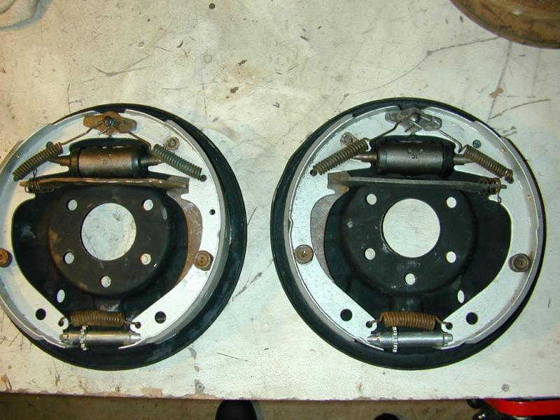

This a pair of reconditioned 11" bendix rear brake sets for the s80 and s800. These have locally-re-manufactured shoe sets with riveted lining material.

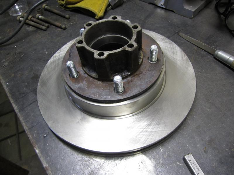

Cant take theses lousy drum brakes anymore and im going disc..... Ill be posting more pictures as I go and will be sharing all the info I discover such as which parts I used and so on... Hope to be done by tomorrow...
disc brake upgrade | facebook
