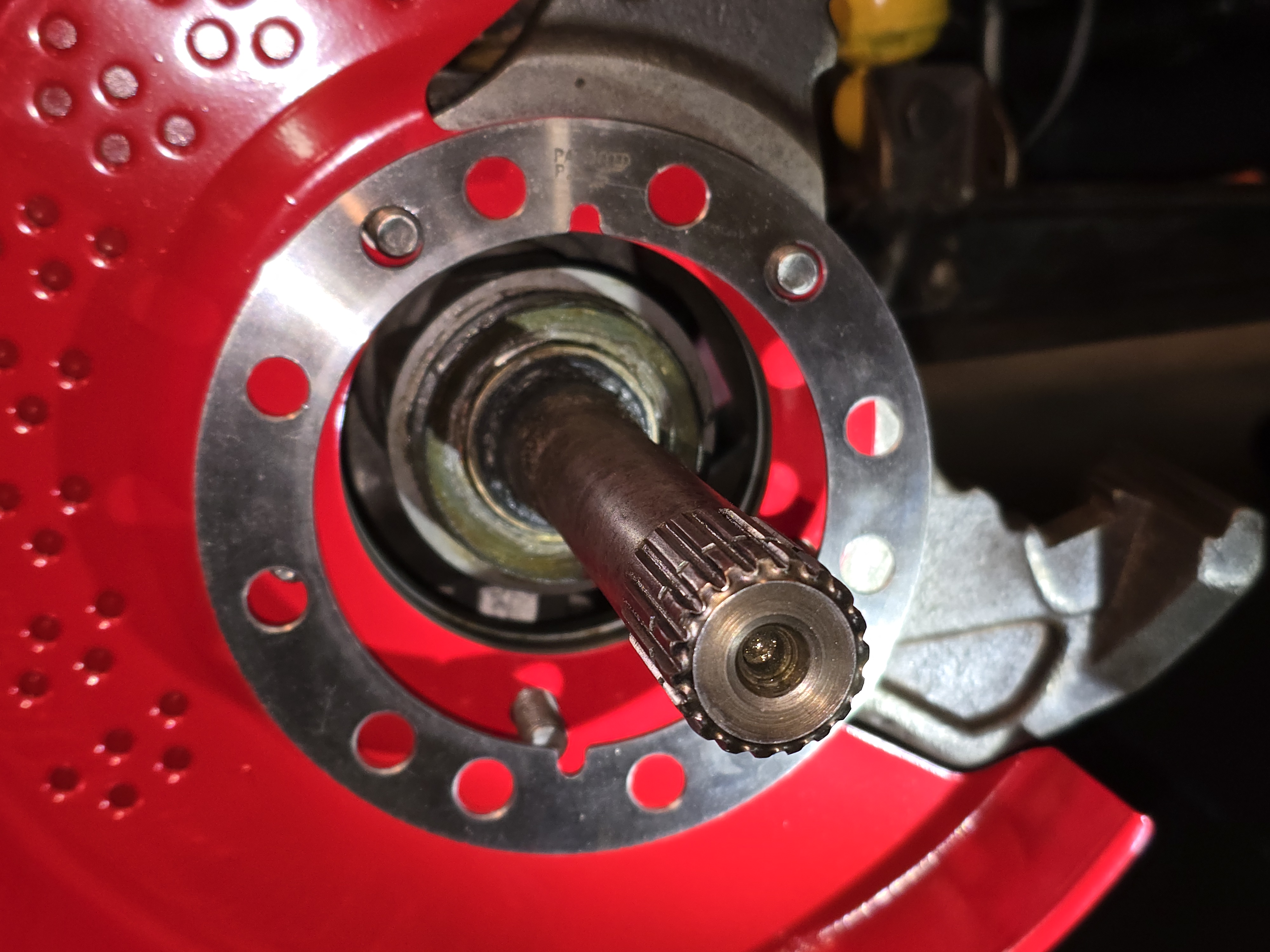

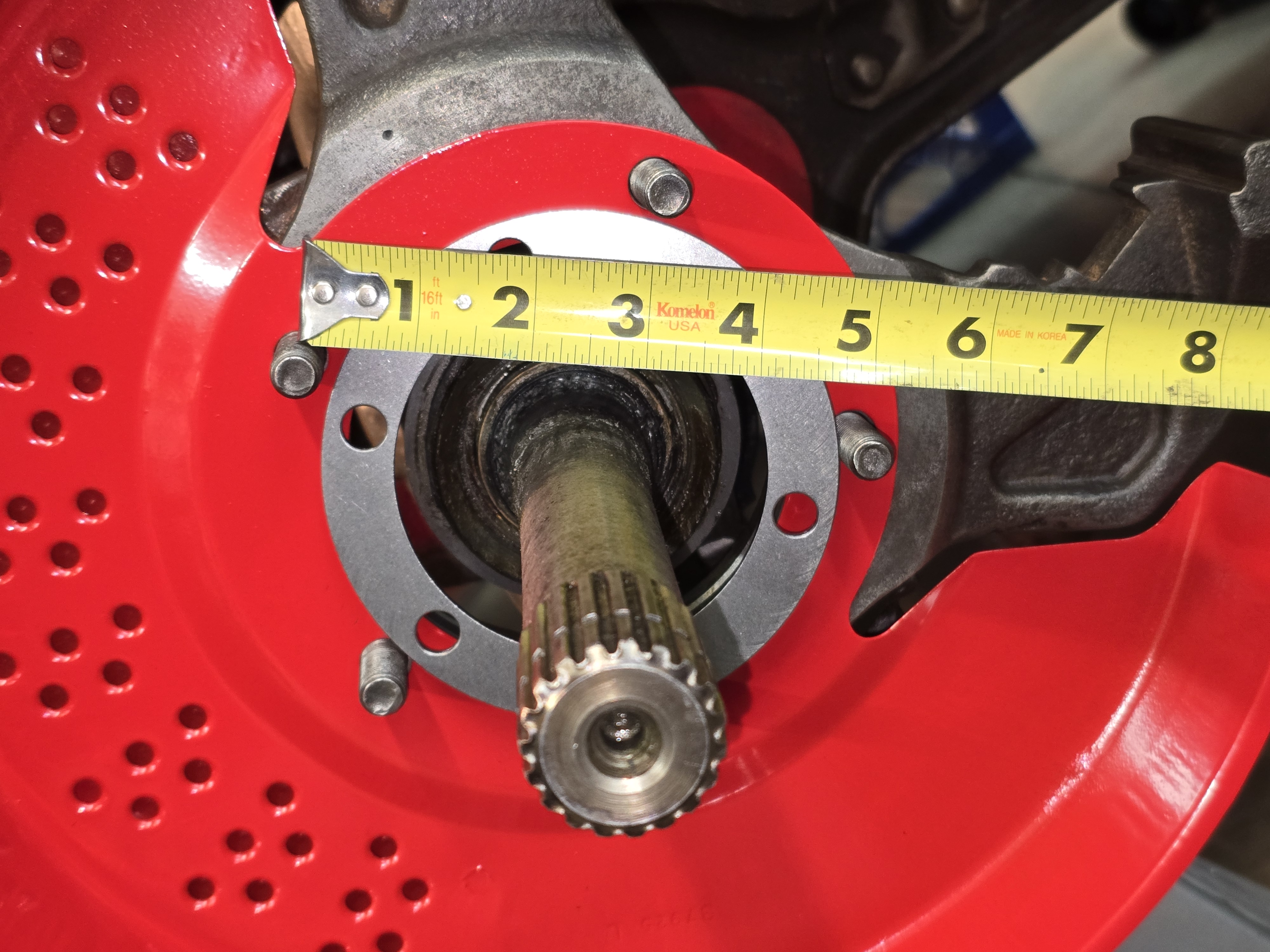

Where, can five bolt camber shims, on a six inch bolt circle, be bought? They are needed for, a 1978 Ford Bronco, with a reverse rotation Dana 44.
The first picture, is of the East Coast Gear Supply's shims. They are six bolt, and I bought them, before I had the hubs apart. I know, don't assume anything! The second picture, is of the spacers, bought from eBay: https://www.ebay.com/itm/133928122053, and they didn't know what they would fit.

Ya these style of shims havent been made in years.
Your best bet is offset upper ball joint sleeves. If you need to remove camber the axle tubes are likely bent.
