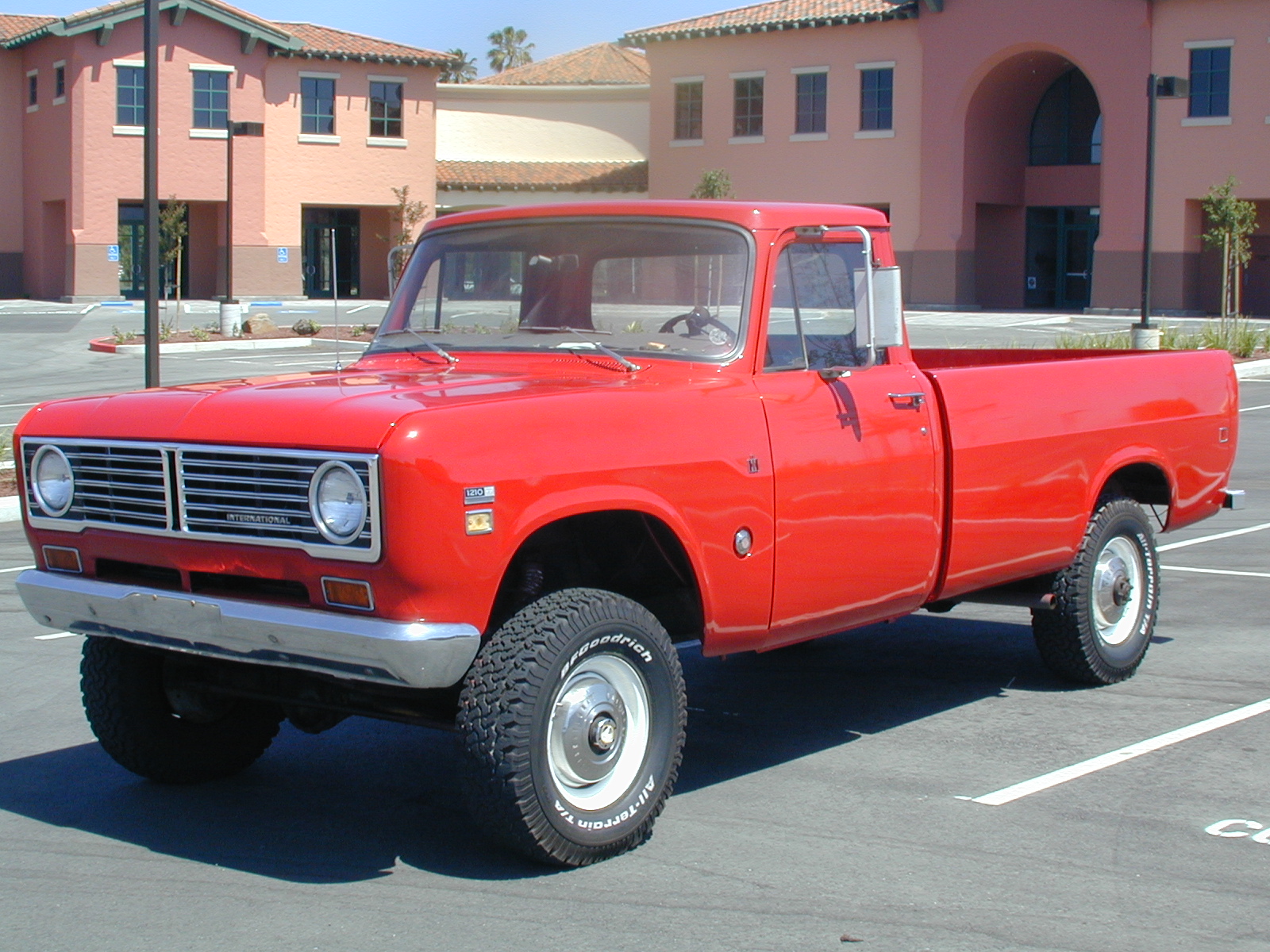

There are a variety ways of doing it. I've done both using an IH Dana 44 and also a Chevy. The IH obviously easier but the Chevy easier to get parts for in the long run, especially rotors. And it basically bolts right in. Mine had the bigger tube so I had get bigger u-bolts. The red truck below has a '77 Chevy 8-lug Dana 44 axle using '71 IH 3/4 ton front springs, '73 steering box mount, a reemed '73 pitman arm (longer than the '74/5), a '74 draglink (thicker than the '73) and steering arm. Of course, aside from the linkages there are the brake lines, shocks, and proportioning valves for disc brakes.

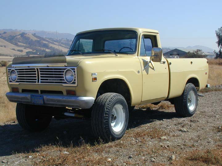

The yellow truck is a 1110 with '70 3/4 ton IH stuff I got from Pick n Pull. Both started life as 2-wheel drives.
