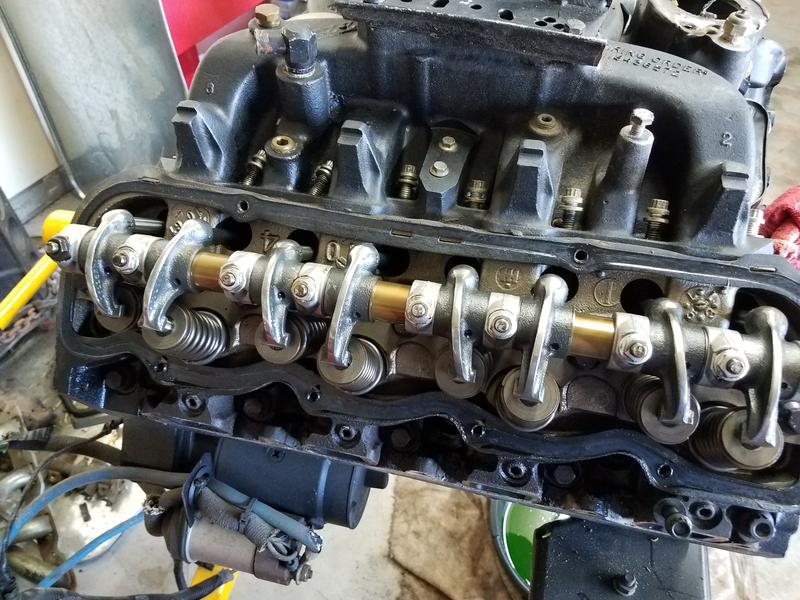

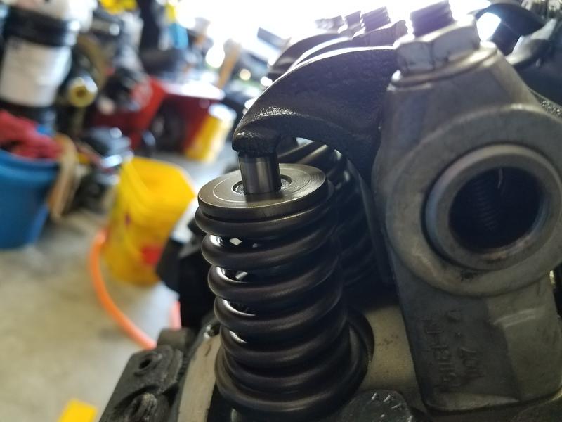

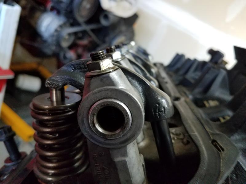

Pics of valvetrain. 58 cast steel rockers bushed. Plated shafts.
