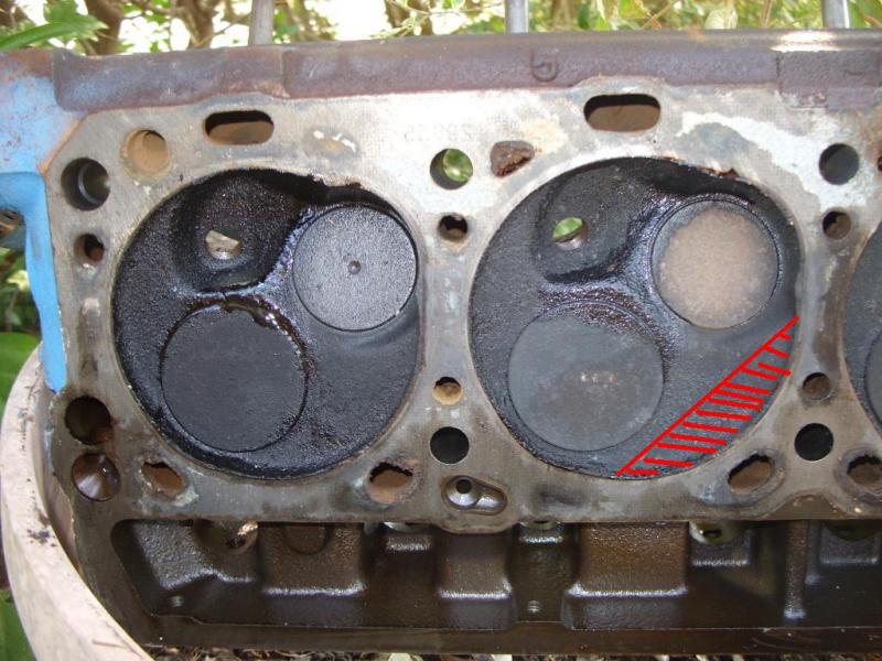

The top is what is referred to as a contoured non emissions version. It uses a completely open, round at the deck combustion chamber.
The bottom one is a emissions styled piston. The combustion chamber has an overhang for quench.
The two combustion chambers will have a visible difference in size. If the flat top piston is used in the open contoured chamber the compression ratio will be reduces significantly.
There are different non ic heads? With different combustion chamber sizes?
On this picture, this engine has the contoured non emissions version.
Does it look like the correct head?
That must mean my other head would be different?
I stole your cc/head picture. Those are all open chambers and need to use a contoured piston..
I added the basic difference you will see on an emissions type of chamber that uses the flat top piston.
Open chamber
Emissions chamber. The red hatched area will be flush with the gasket surface. It provides what is called quench/squish that improved detonation resistance and a better quicker burn rate. Aids in emissions reduction.
