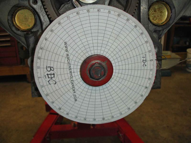

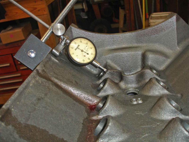

I've attached two images showing my degree wheel and indicator setup.
Thanks for your help, I think that I’m good to go.
Johnnyb
