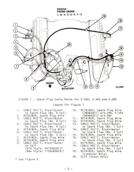

Thanks guys. This is the bulletin I was going off of:

thanks guys. This is the bulletin I was going off of:
Yes, that bulletin was pertinent given the oem technology at that point in time. But in the past 35 years much has changed in the engine component and aftermarket world!
Secondary cabling at the point in time when that bulletin (and the assembly line process) was pertinent involved the use of a graphite/carbon matrix (along with either cotton, rayon, or nylon fiber support) for the conductor. That material has an approximate resistance of 2,000+ ohms per foot of length. That was used in order to attentuate rfi (exhibited as crackle or static on the am radios in use at that time) per federal requirements. And that cabling promotes inductive crossfire when an engine has a firing order where two cylinders are adjacent in the firing order and the affected plug cables are run parallel to each other (even when separated by some distance). The simple fix for that condition, simply cross the two cables over each other at some angle less than 180*. That effectively attentuates any possible inductive crossfire.
Instead, ihc chose to route the offending cables well away from each other, and yes, that works also.
