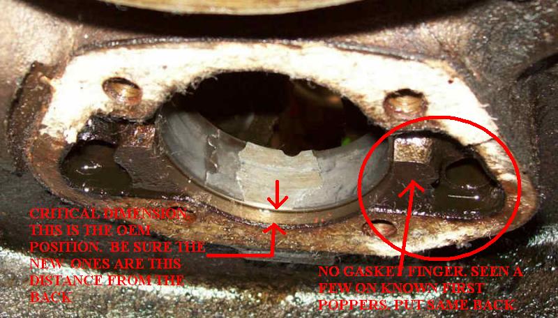

1) The correct location for the rear bearing is even with the back face of the cam when the cam is being located by the retainer plate in the front and with the cam gear installed. When you groove the bearing you are actually undercutting the bearing surface where the cam runs. All that should be beyond the rear cam face is any chamfer on the ID of the bearing.
2) The gasket thickness and recessed position of the bearing in the bore give 1/8 +of gap for oil to move from the came diameter to the lifter passages.

Example of proper rear cam bearing location below. This is a first time cracked open SV

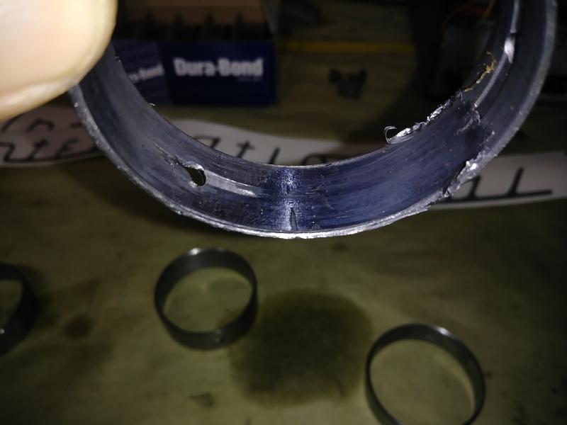

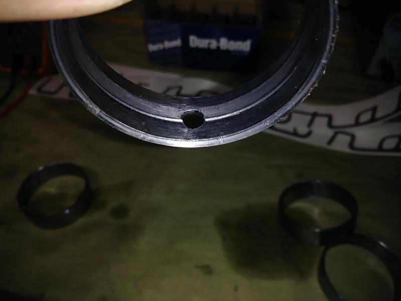

These are my bearings I have removed. I apologize for the poor picture quality, I was trying to show how far off #5 was, and the oil port was closed as the one shown on the #2 bearing in the picture. In you guys opinion, should I worry about other problems, or go with the idea #5 was placed wrong. Should I reuse the cam? It shows no signs of wear, I have put a mic on it, and It is completely true in round. Sorry for all the questions, I just dont want to pull the engine anymore after this.

Following the instructions in my post above are best. Your choice on replacing the cam and lifters (I would) and make sure you polish the journals the correct direction.
This cam has to glide when you try to turn it lubed with fingers.
