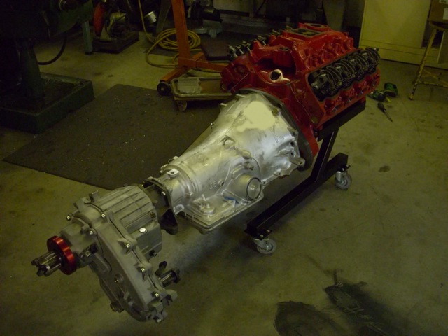

I have a 75 Scout II with a 345 in it. I am planning on putting a 700r4 with a NP208 case behind it. The transmission is the hd version with the k on the tranny case. Will the transmission fit inside the Scout tunnel or will there need to be any fabrication to the bottom of the floor pan? Also will there be any issues with the angle for the driveshaft? Will custom shaft need to be made?
It will fit a few of us on here are running the 700r4 NP208 combo. Make sure you account for the tq converter lockup and tv cable or you will fry that thing in a few thousand miles
Lots of info here. Jeff sells the kit, so if you search the "IH only buildups" you'll see how they look. Its where I got my inspiration and motivation.
This is how it looked prior to install. Be sure to post up the pics. We love pics!

What issues do I need to account for with the torque converter and the tv cable? Also will there need to be any issues with the drive shaft angles?
