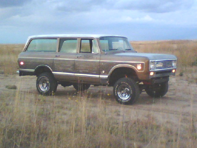

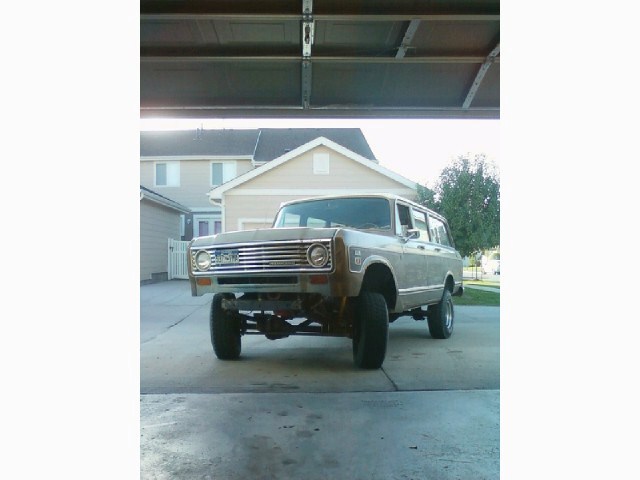

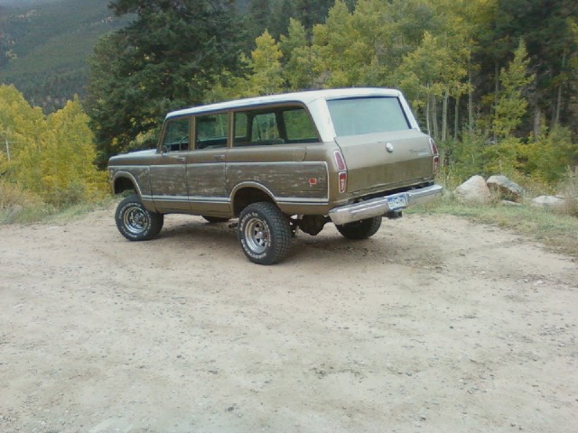

This here is my 1973 Travelall. It was originally a 1010 truck, somebody in its past swapped the body, engine, and tranny to a 4x4 chassis. The body is in great shape, but the front fenders are going to be replaced, the po had 35" super swampers on it, beating the crap out of the fenders. I swapped the axles from a '75 pickup, cause I wanted disc brakes in the front, swapped the brake system from the pickup also, po did wierd and dangerous stuff to the brake lines coming off the master cylinder. It has a 392 with prestolite distributor, 600 cfm edelbrock, 727 tf, NP205, 44 front, 60 rear, 4.10 gears. $825 I paid for it, daily driver! My wife likes the looks of the 74'-75' grill, hood, so I installed those.
