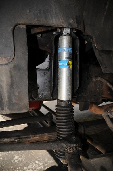

I thought I would post a picture of the new front shock mounts that Jeff and Darrin put on my Travelall at the end of oct.
Over the years, the rivets holding the original front shock mounts to the frame have "failed".
The resulting "repairs" were much less than satisfactory -- not enough front "shock travel".
After finding out about ihonlynorth (and seeing the excellent work in their "builds"), I finally called Jeff to ask if they could "do something".
Darrin cut off the old welded on front schock mounts and put a set of the Ford mounts they use on scouts. Plus a set of bilsteins at all 4 corners.
The ride is much better.
Thanks, Jeff and Darrin

This is outstanding to see an original, unmolested rig that is upgraded in such a nice fashion without being a hack job! What an improvement Robert!
Them ihon kidz are purdee dam special ain't they??

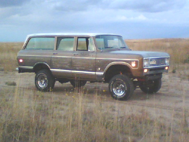

I know this post is a year old, but thats nice truck you have Robert. I once drove a 3/4 ton '73 t'all 4x4, with the 5 speed, I should've bought the truck! The engine was worn out, but it still had power, the od was really a plus. I remember years ago my father talking to a guy that owned a '74 t'all, 100 series, this guy bought the truck new with the 401. He replaced it with a 392, the 401 didn't have the torque the 392 did. The 401 hauled ass, towing power wasn't worth a crap. I have a '73 t'all 4x4 with a 392, 55,000 miles on it. Needs paint though. My wife liked the '74-'75 grill and hood more, so I installed that.

Nice to see a picture of a nice t/a -- amongst all the scouts...

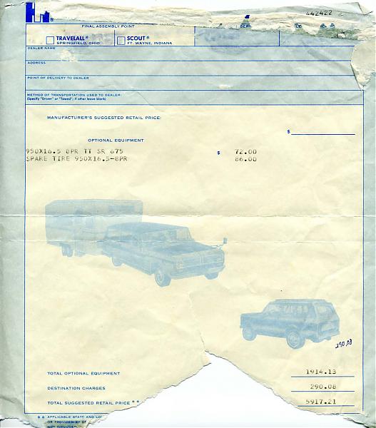

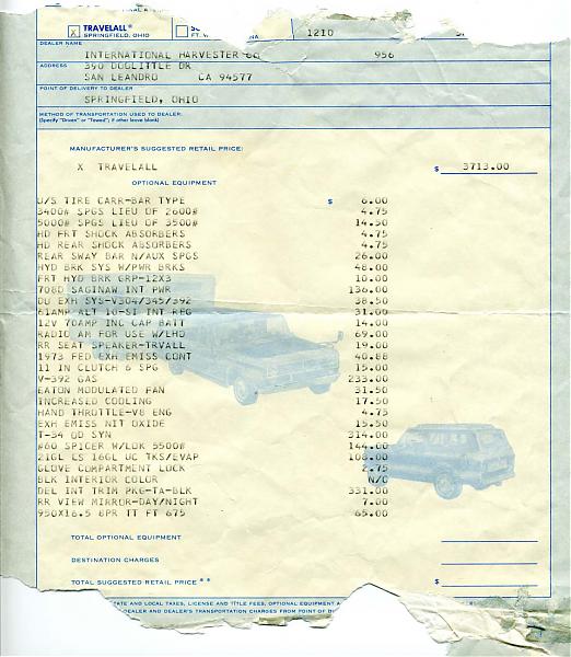

Sticker price was 5917.21 -- paid with tax & license 5332.08 (not counting interest)
For those who are interested (or bored:crazy: ), here is a scanned copy of the window sticker for this t/a:
