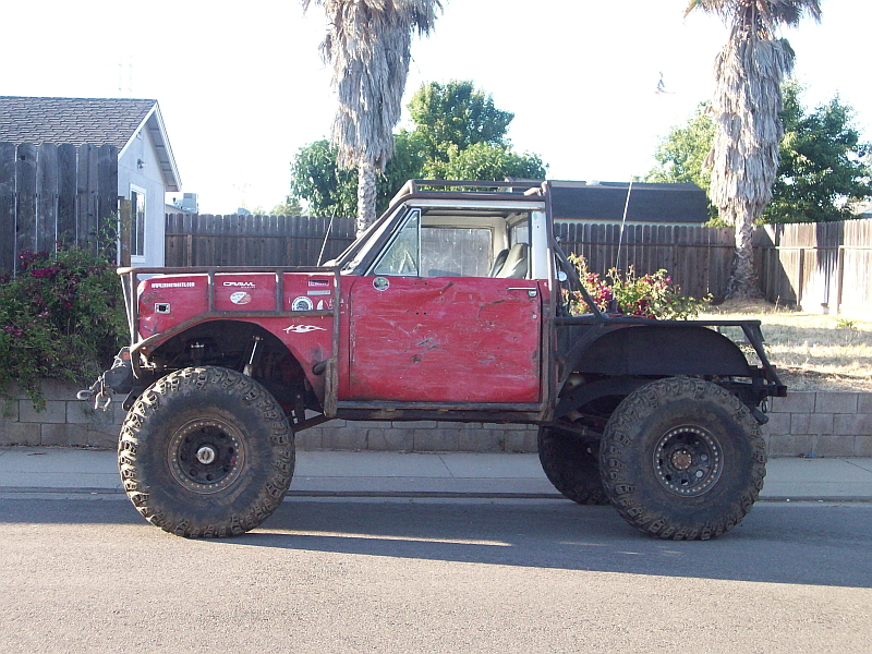

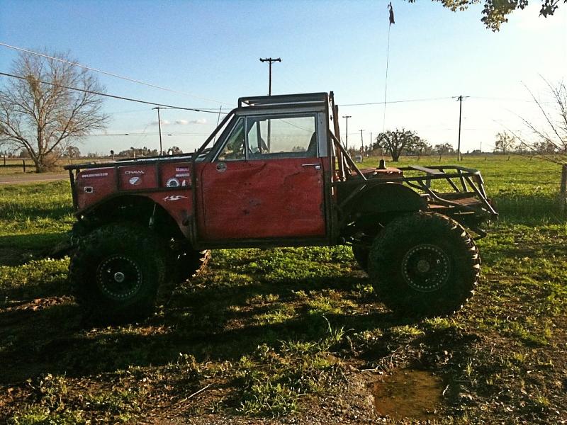

How I purchased it with lop-sided lift, lots of rust and carnival colors.

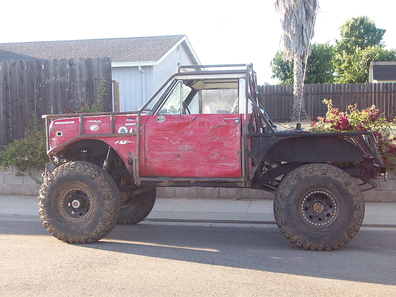

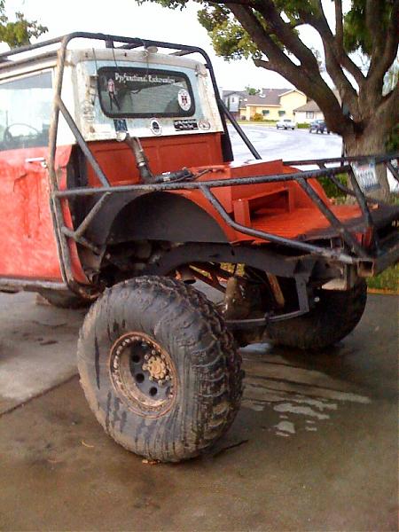

Rollbar addition and roof removal -

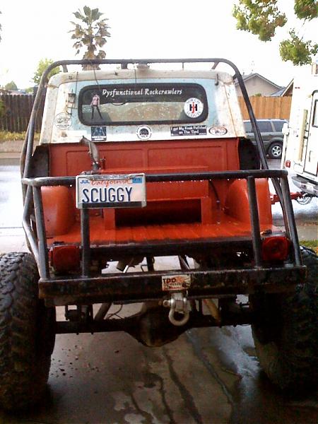

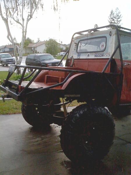

Wheels powder coated and mounted on 33x12.5x15 gt adventuros. Shackles from IH Parts America, push bar and rear step bumper installed.
Far from perfect, but perfectly enjoyable.
Better shocks, valley pan leak, rear bearing plates, hidden rust repair next on the list.
Oh and a fan shroud hunt has begun as well.
Happily - the dash is stock. I added a vintage radson tach to the column. The corbeau seats and tuffy box make in the interior pretty comfortable and the storage is nice.
