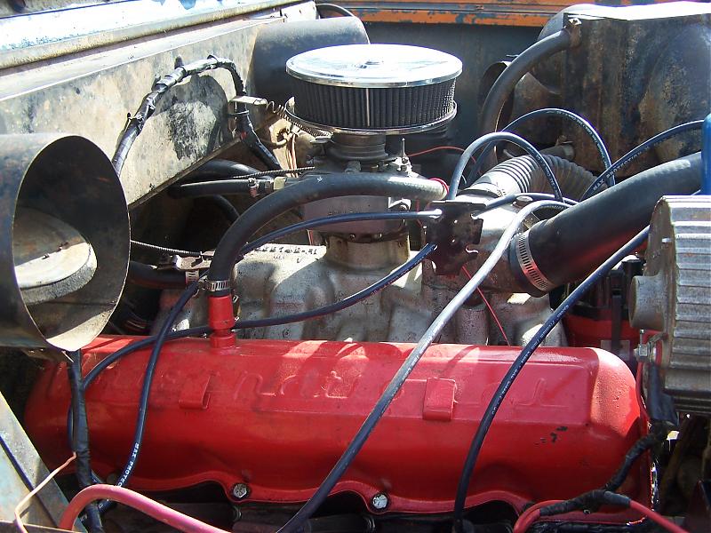

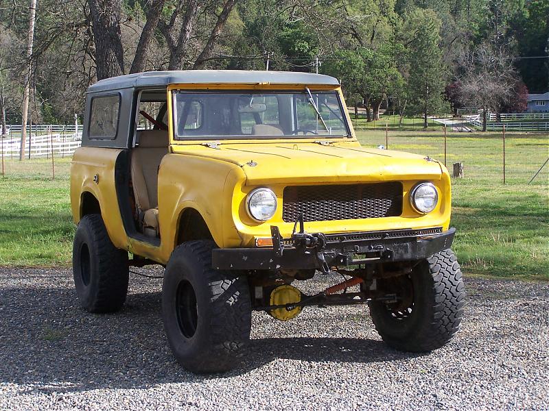

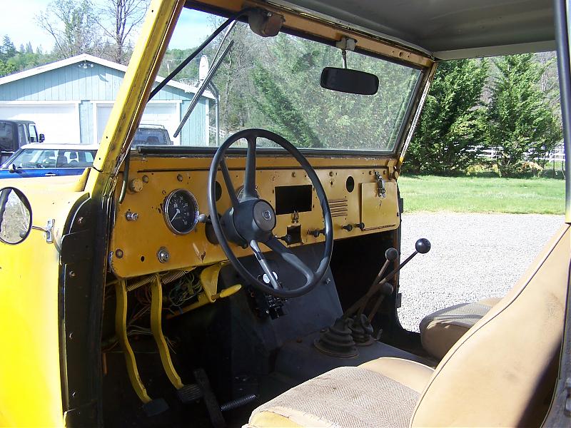

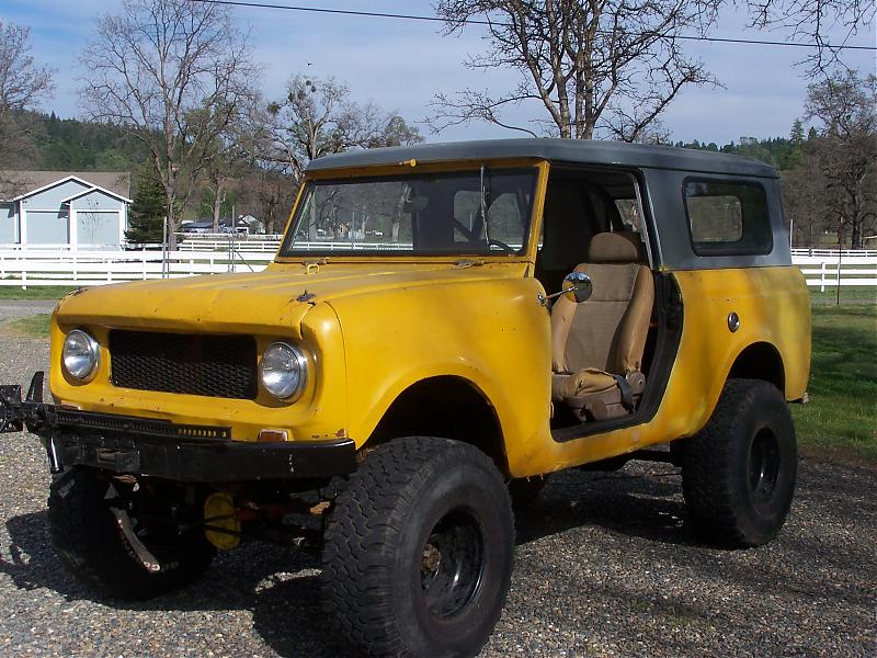

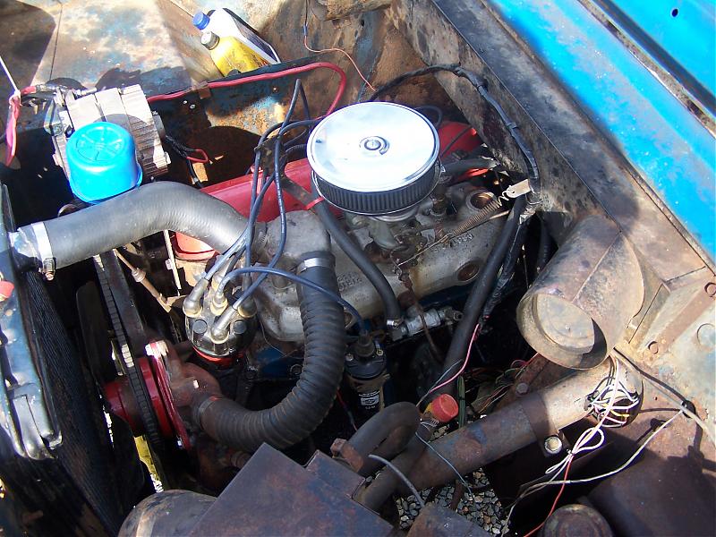

1962 Scout 80- my first Scout. Hopefully one day it will be ready to wheel in the snow. Sits on 35's SOA with 3in blocks, power steering conversion besides that its pretty much original. It has a Scout II gas tank that feeds through the bed. Original 152c with Holley 1904 3sp 4.27 gears with Dana 18 twin stick. Dana 27 axles (with rusted shut lockouts). Engine is getting all new gaskets and a tune up. Front needs to be shimmed to align the lengthened drive line, total interior overhaul, it'll run down the road drove from folsom to placerville but bring oil!
