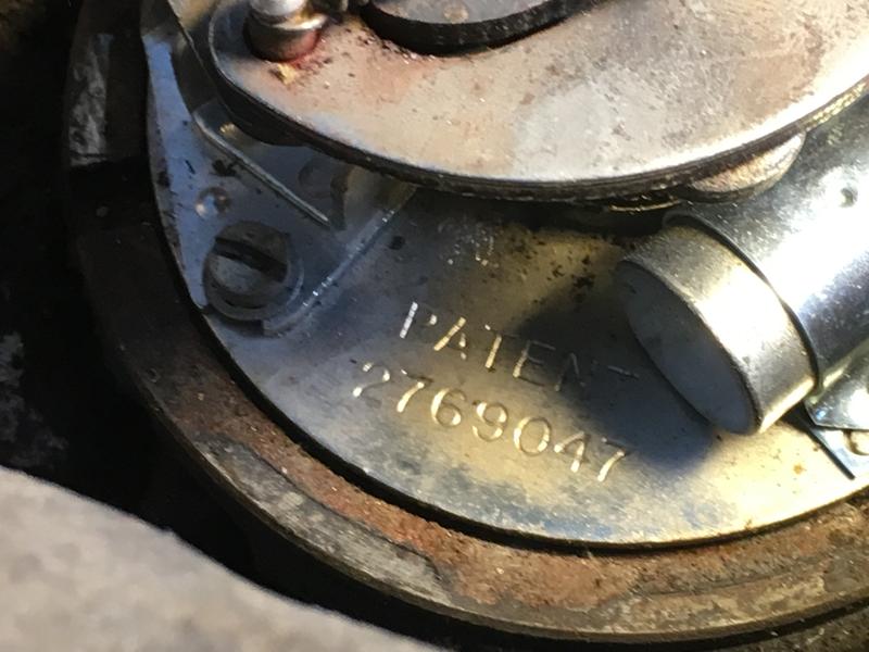

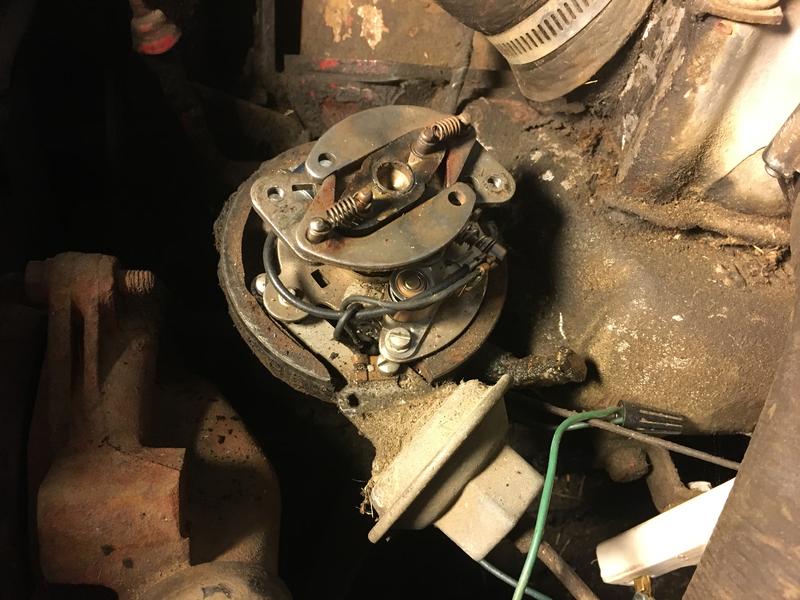

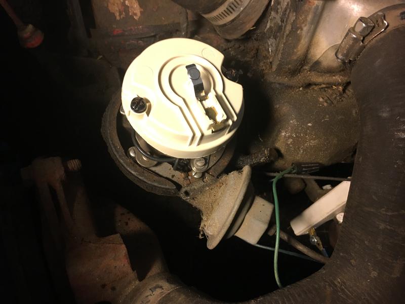

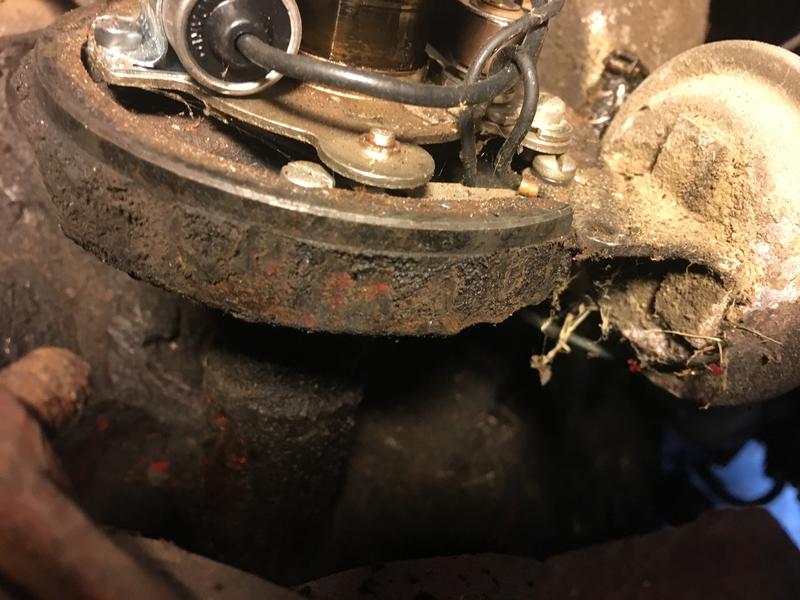

I wasn’t able to tinker at all because I worked today. I got a few pictures of the distributor though. I’ll post in a few days when I get a chance to tinker with it.
Didn’t see any serial number on it but I didn’t scrub through the muck.
Apparently I don’t know how attachments work. Haha

OK, thanks for the photos.
That is a GM-Delco distributor, and probably the original unit.
It is very dirty.
It looks like the points, condenser & rotor are fairly new.
Be sure the rotor is installed correctly.
It has a square peg and a round peg on the bottom of the rotor that fit into the distributor.
Check that the ballast resistor is not burned out and is connected to the coil + connection.
That is the small white rectangular item in the first photo.
