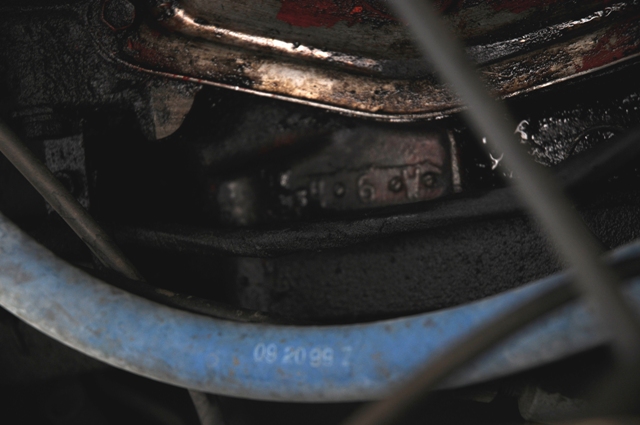

There is a date code on the "back" of the engine block -- "center" / firewall...
If you search on the binder planet, you should find a post where someone listed the years that match the letter

from my 73 392
