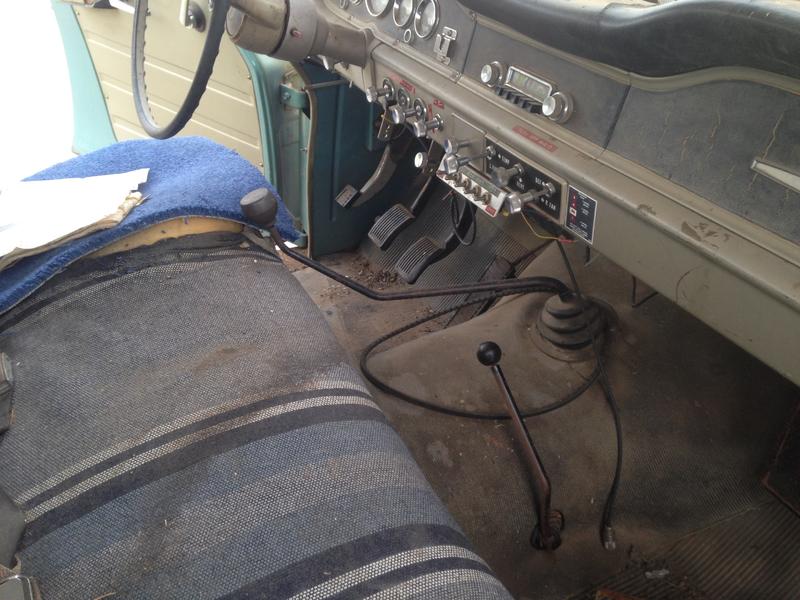

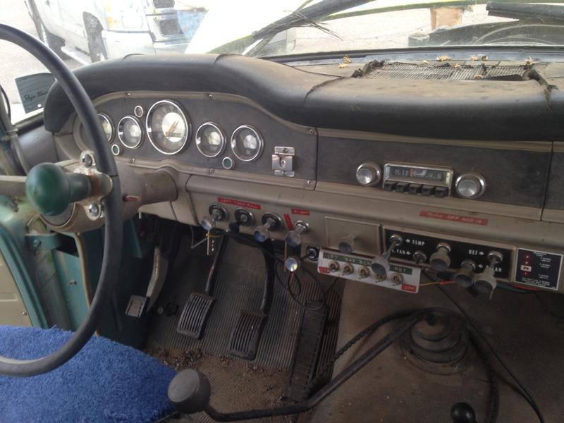

So, diving into my first build of any sort, starting with a 1967 Travelall (1100b) 345 v8. Waiting on the LST for more specifics but has been parked since 1993. Was used as a volunteer fire department response vehicle. Engines turns over, fuel tanks need attention, carb likely needs attention, tires and wheels need love, clutch is mediocre at best, interior needs a thorough run through. (nicknamed the hornet for its yellow color and 5 hornets nests in the interior ) been out of town almost entirely since I bought it, so am now able to get started on it. Forgive the acorns and nuts on the motor, still have lots of cleaning to do!! Looking forward to getting the hornet buzzing!
5-15-15 changed oil, filter, replaced battery. Engine cranks and starts with fuel directly added to carb. Next step- drop fuel tanks, flush cooling system, replace belt. Replace spark plugs. Sounds like a great Saturday! Hope the weather holds up!!

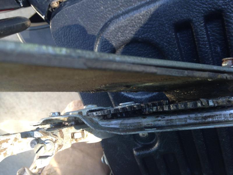

Took some time this weekend to clean off the glue/grease from the rear window gears. Looks like the "pin" holding the 3 main pieces together is partially broken which is causing the gears to sit crooked and rub things they shouldnt. The pics below will show the broken edge of the pin and how the gears are currently sitting. So thats another curveball ill have to figure out down the road. Also took more time to agitate the fuel tank with some rocks and gas and tried to get it cleaned out as much as possible. Also drained and refilled both diffs. Front was bad!! Almost a gray color fluid with what looked like clumps coming plopping out. Ran my fingers through them and couldnt feel anything solid in the drained liquid. Also pulled off all the radiator hoses, and am waiting for them to come to the local shop along with a new drive belt. Pretty productive weekend, but still feels like there is a ton to do.

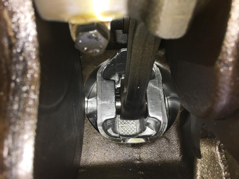

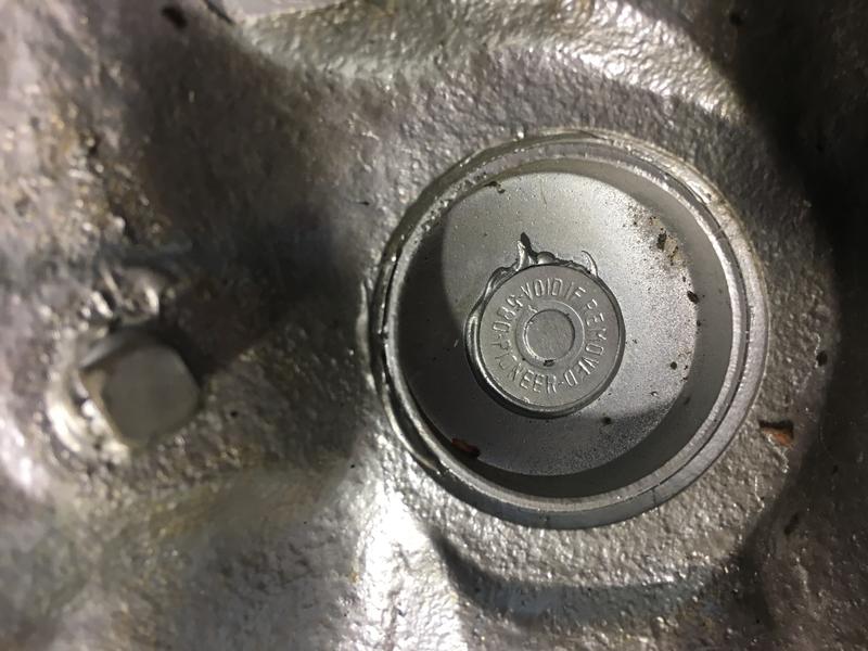

Wow, depressing to see the last time I updated anything on this was Aug. 2015! Needless to say, a lot has happened since then, (Thank God) most of it good, but none of it easy.
Worked with mechanic Rob, who wanted nothing to do with it and through a stroke of luck, convinced him to look it over and prioritize its needs.

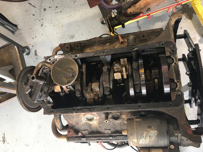

Long story short, he wasn't confident in the original motor, constant smoking, lifter noise, and his refusal to rebuild. I made quite a few trips to Coonrod, and came across a 345 he already had pulled, and he was confident in without knowing much about it... Turned out to be a gem. From what we can see, it was rebuilt, and the cylinders appear to be in great shape! (Photos included).
Because Mechanic Rob didnt want anything to do with it in the first place, I couldn't push him for time, it was a side project, but trusting him, I was good with it.

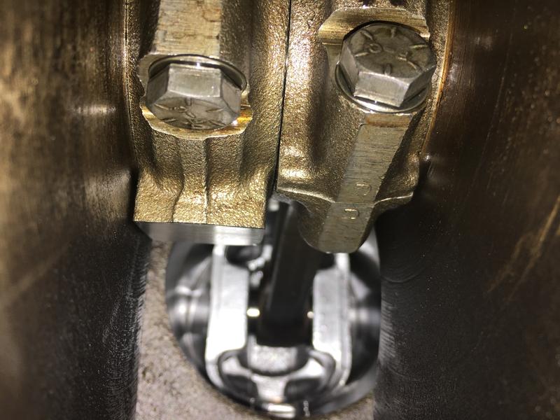

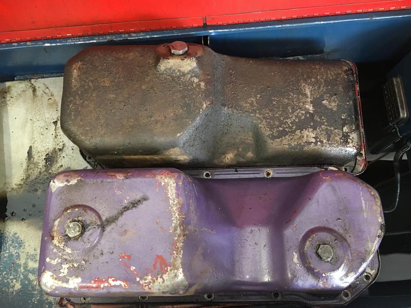

Next Curveball came when we flipped the two motors, the oil pump assembly/pans were different. (Photo included) but the "new" one barely fit. (I think the "new" motor is a newer IH 345, if anyone can identify the different Pans, that would be AWESOME!) Clearance to the pumpkin with the new motor is REALLY close, so now Im working on suspension options to give some cushion while also updating the 50 year old original springs.
While the motor was out, we turned the flywheel and installed a new 12" clutch kit, new carb, New plugs, wires, mech fuel pump, water pump, and had a local shop do manifold back exhaust.
Also found a local legit radiator shop to boil and seal one of the fuel tanks.
Hornet is now registered, starts right up, sounds great, but is only being driven a limited amount, due to the closeness of oil pan and pumpkin.
Top of priority list are: rear window mechanism, windshield, and rear curved glass. Any leads or information would be great! I am back to being excited about this build, so I expect to have more to post sooner than later, but still a lot of work to be done!

The "new" engine was pulled from a Scout chassis. That is why the oil pump and oil pan are different. They are like that to clear the front axle on a Scout.
Simply rebuild the 'old' oil pump and install it and the old oil pan onto your "new" engine.

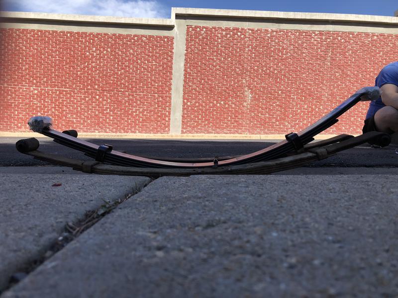

Ordered custom springs from Alcan mid Feb. Asked for +4" from factory, with a little extra weight in the back, mostly cause I'm not 100% sure what this vehicle will turn into. Once they are, the Hornet will start seeing more drive time, and the next priorities will likely move to the interior.
