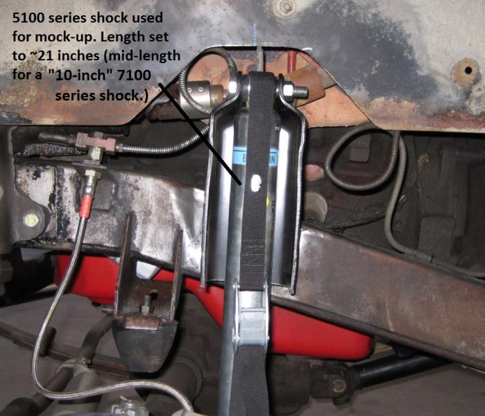

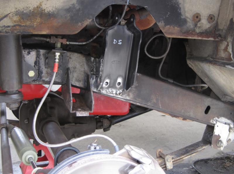

Hi. I got a little further along with the project this weekend. Both the right and left shock towers are tacked in place. For now I just have those borrowed blstn 5125s mounted. They will work until I have everything finished. Then I'll mount my nice new 7100s.
I'm going to hold off on doing the complete welds until I can take my Scout out to a place in the local hills and get the suspension all crossed up, and then make sure there is no unwanted contact. I don't think there will be any issues, based on how everything looks straight and the shocks clear the tower shrouds by a decent margin. But I just want to be sure. I May not be able to do this check for some days though.

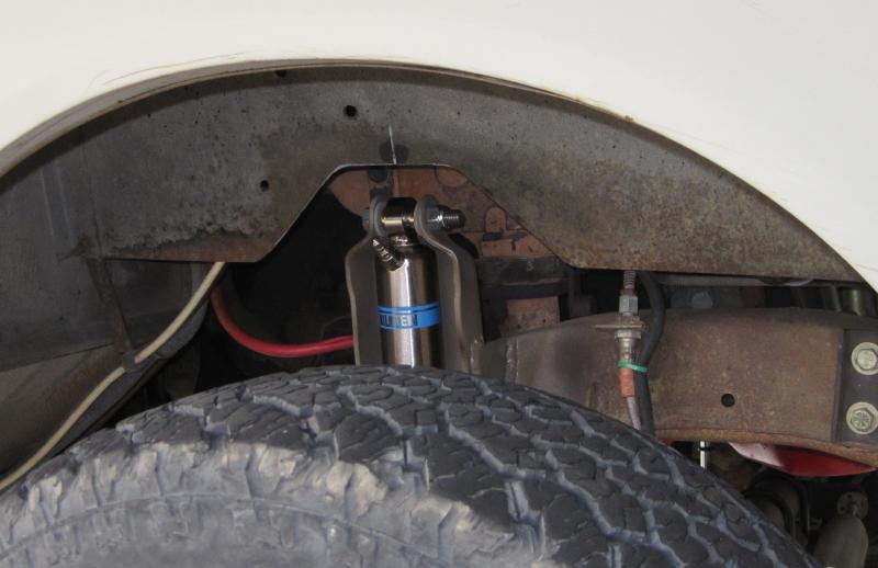

Update: I have the front towers welded in now and ready for a little paint. While the towers were still just tacked into place I did a fit check on a rutted trail nearby, getting everything crossed up pretty good, just to make sure there were no clearance issues.
I have to say, the ride is really nice with the bilsteins. They are a big improvement over the r9000s. The Scout's front end seems to handle better and the suspension is now allowed to work in soaking up bumps.
So far this is only half of an improvement though. I need to bite the bullet and order a set of 8" 7100 shocks for the rear end. For example, just for fun I drove over a 6" curb at about 6-8 miles an hour. When the front tires hit, I didn't so much as feel the curb as hear it. But when the rear tires hit, boing, the whole back end jumped up in the air and and launched my loose cargo airborne momentarily.

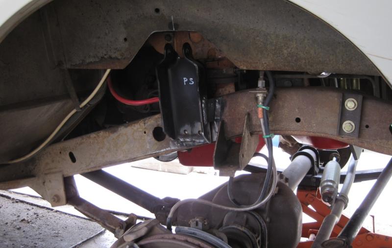

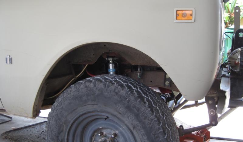

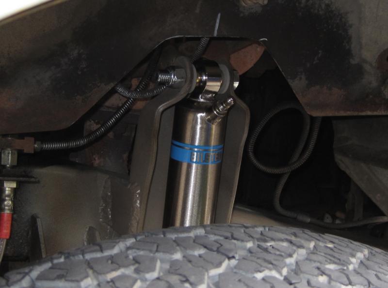

All painted now. Here are some in-situ pics of the 7100s.
I'll need to wait at least four weeks for my rear 7100s from the time I order them, since the 7100s are made to order at Bilstein.
I'll update this thread when I get them in.

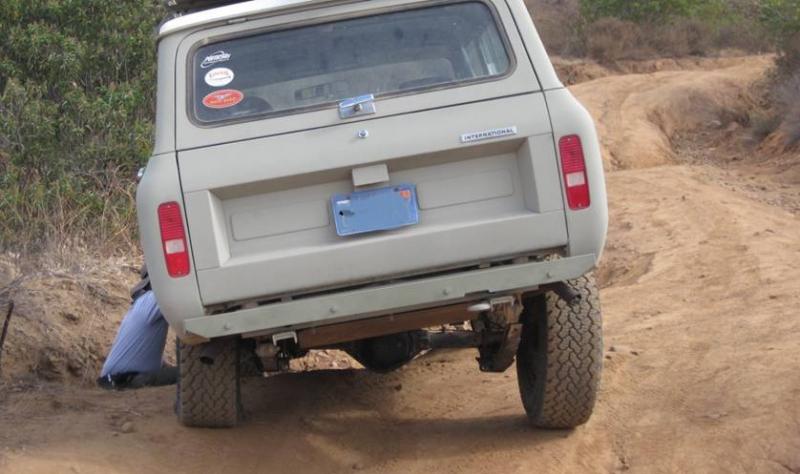

Below are pics of my Scout getting the suspension crossed up in a big rut so that I could check the clearances on the tacked-on front towers and also to measure the travel on the rears when full stuffed. Pulled the ranchos off the truck to do this. Turned out to be unnecessary since the rear doesn't actually change much, at least where the shocks are concerned. So the 8"-travel 7100s will be fine back there using the existing shock mounts.
Btw, that's a buddy of mine in the pic; he was spotting for me. He's the guy who just put the fox 2.0 emulsion shocks on his '72 Scout with very favorable results.

As to your other question about the front mounts, yes, I tilted them out a little---that's why the gussets you see in the pics. Otherwise I was afraid the shocks wouldn't clear. And they wouldn't have. The frame has a weird indentation right there on both sides, you May have noticed. Mounting them "flush" would have actually tilted them in a little.
How I positioned the towers correctly was by using a handy tool my buddy (in the pic above) made. It's kind of a dummy shock that you can set the length with a set screw. I used it to position the towers at the correct height---about 21", mid-length of the shock---and then tilted out the towers slightly before tacking them into place. Worked great. I'll try to post a pic of it this weekend.

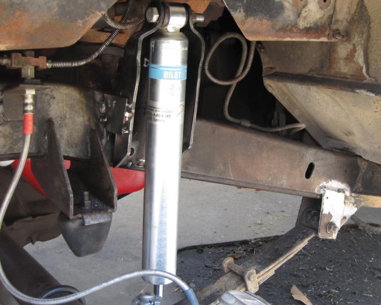

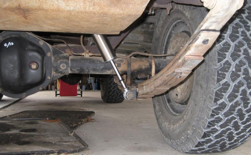

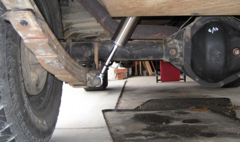

Okay.... My rear bilsteins are in. Not to exiting to look at I guess. You might be able to see the big rubber o-rings they put on the shaft. It shows the extent of compression after I'd hit a few speed bumps at various speeds up to about 20-25 mph.
Btw, the spring plates are from Scout madness. And I modified them a little.
These shocks are definitely more compliant than the ranchos and let the springs work better. Can't say yet if they're better, the same, or not quite as good as fox though.
Eventually I'll want to re-do the fronts' lower mounts to move them outboard a little, by about an inch on either side. Mostly it's just for looks to make them a little more straight up and down rather than tucked in. Personal preference.
