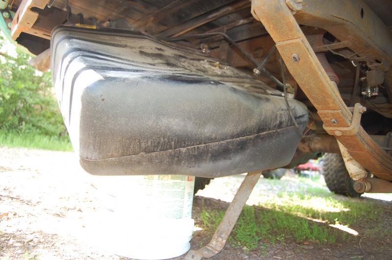

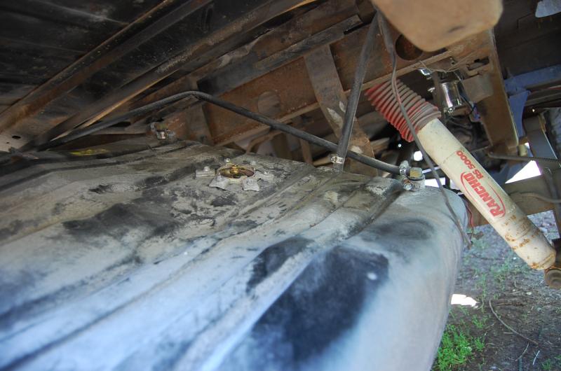

Anyone ever install a new fuel pick up on a plastic stock size tank? I just put in a autometer fuel sending unit and it does not have a fuel pick up line attached. Thanks.
79' Scout II 304

Originally Posted by antonsone View Post
anyone ever install a new fuel pick up on a plastic stock size tank? I just put in a autometer fuel sending unit and it does not have a fuel pick up line attached. Thanks.
79' Scout II 304
Aftermarket fuel level senders such as supplied by autometer and others are not intended to be an exact replacement unit for an oem sender. They will not have the "dip tube" for fuel liquid pickup as part of their design. They are intended for generic installation in marine tanks, auxiliary tanks, etc. That use a separate dip tube/feed to the fuel pump.
It might be possible to fabricate a dip tube assembly and install in that sender if there is sufficient clearance. Post a pic of both sides and I'll look at it. Otherwise, a separate dip tube will have to be fabbed and installed in some safe manner.
Are you also installing the companion autometer fuel gauge? The autometer fuel gauge and it's companion/matching sender are powered directly from switched b+ and cannot be run from the oem constant voltage regulator (cvr) instrument reference signal on the oem sii instrument pod.

I connected all of my new sensors into the old harness, is the issue with the cvr that you just mentioned evident?
Also I might try and install a bung on the lower side or top and dismantle my old fuel pickup and drop it in.

The oem cvr is mounted on the rear of the oem temp/oil pressure gauge pod and connected to the oem fuel gauge through the oem instrument harness and printed circuit boards.
So after seeing your setup which requires b+ for gauge power and does not involve the oem cvr, it should be correct if the sending unit is the proper resistance range match for the fuel level gauge. I believe the autometer gauge requires the companion "0>90 ohm" sender,...the oem sender won't work with that aftermarket gauge since it's resistance range is different. The isspro aftermarket gauges we sell here at ihon do use the oem resistance range, so the oem fuel sender can be used with those, that is why we handle that line.
So what you are doing is simply using the oem body harness/wire to connect the replacement sender to the replacement gauge, that will work fine as long as the grounds are rigged properly for both the sender and the gauges.
Likewise for the temp gauge, the oem engine sender is not the correct resistance value for the autometer gauge, so ya use the sender that came with the gauge which is the correct value.
Those aftermarket poly tanks use "spin-welded" bungs for the vent taps I believe. That is a process that can't be duplicated at home, but some rv shops can install those since the process is used on rv poly holding tanks and marine tanks. Most replacement rv tanks are "blanks" and the installer simply installs the penetrations/fittings where needed for each replacement.
Also, one of the poly tank "vent" bungs do I see at least two of those in the pics??) could possibly be adapted to mount a fabricated dip tube as long as it was done in a safe manner. I've not tried to do that but look at that and see if it's feasible.
