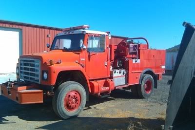

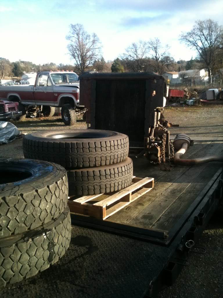

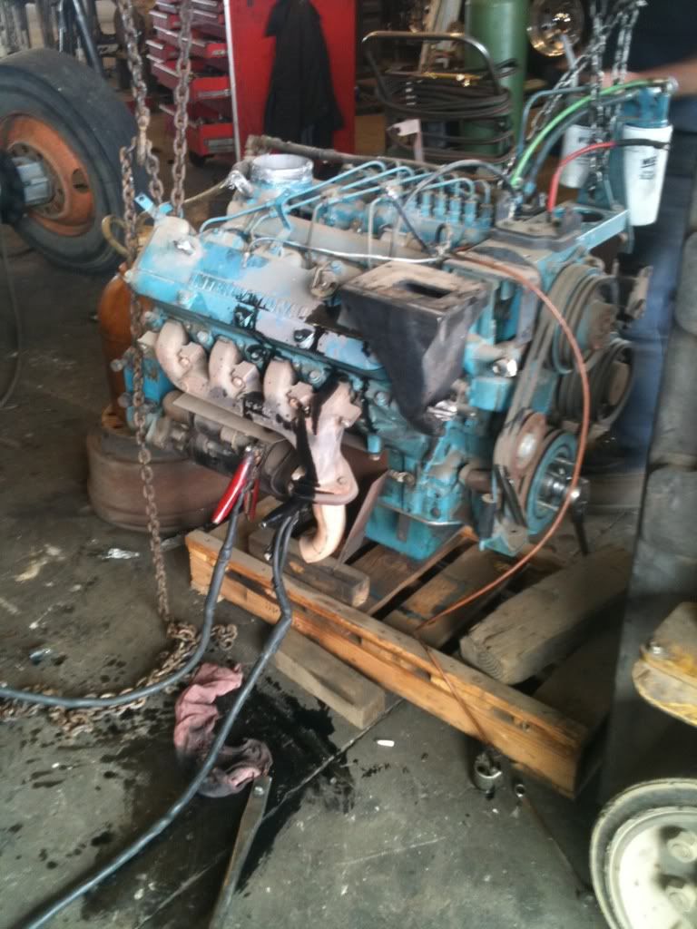

I am currently restoring a fun little toy, I am a big Jeep guy. Infact before this truck, the only IH product I owned was a Scout II axle I put under a Jeep. Now I can safely say that I am swimming in medium duty IH parts! Haha. As the truck sits right now, it needs a motor... 9.0l ahhh. I have dt360 sitting on a trailer but it won't fit. So I sourced another 9.0, fingers crossed that this will get her rolling. I was stoked to see a IH club in the bay!!! I hope to meet up with you guys.
Specs
9.0 liter
allison mt643
harrington axles
fabco t-case
and a bunch of cool odds & ends
here's before I bought it. Hadn't been in service since 2007.

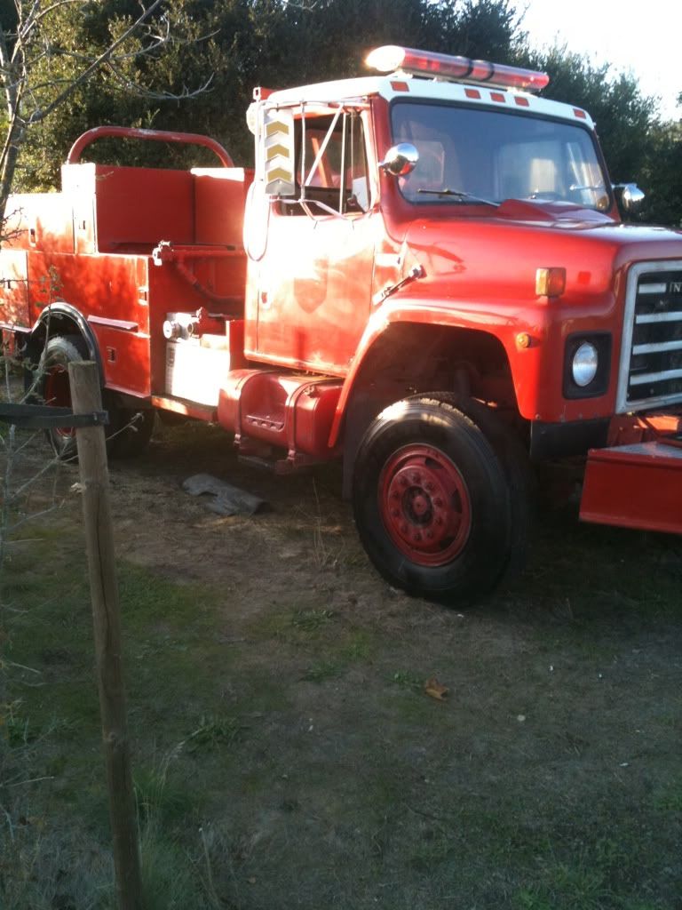

Buffed the snot out of it,
Let the parts come!!!

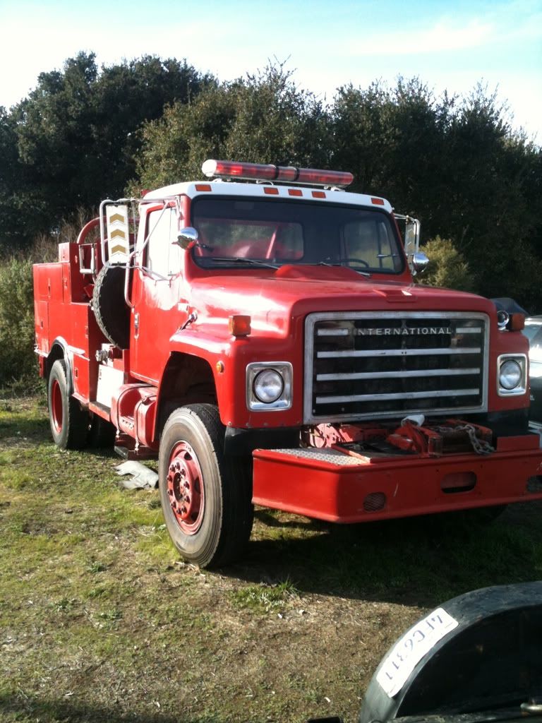

This is the most current state as of now, just pulling my resources together for the motor swap! When you have to rent a flipping fork lift to pull the motor, the reality of the project sets in and your doing a bit more then dropping a v8 in a cj5. Haha

Default Re: 1982 International S-1800 4x4 Fire Truck
Thanks marko! You bring up a really good point, and something I haven't considered. The 7.3 would be easy to get ahold of and it would be easy to replace... Ummm. The other 9.0 I found came out of another truck just like this one. It supposedly has 6x,xxx on the clock.
I measured the dt360, and while I could make it fit... I would have to move, just about eveything! I guess I am in a rock an a hard place. Everyone tells me to dump the 9.0l and drop the dt in it. I live about an 45 mins away from the truck, and that makes my choice even harder.
9.0l
pros- bolt in swap, spare parts motor, cost would be kept to a low, it would be a runner in a few months.
Cons- motor could have 26x,xxx miles, waste $1000, parts arn't hard to get... I checked, but there $$$$$,
dt360
pros- great motor, parts everywhere, tons of mods, easier to work on
cons-have to shorten stub drive shaft going between tranny & t-case, move back tranny, move forward motor, relocate a bunch of stuff on the motor, dog house would be in the way of winch controls, 3 throttle cables relocated, exhaust, and I am sure some other stuff. Ahhh. Project wouldn't run in this year

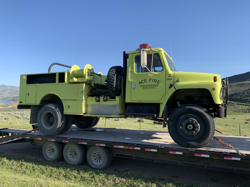

Good luck on the truck. Here's the one I get to use:
You've got a type 3 there, is there an auxiliary pump or is it pto driven?

Old 02-08-2012, 12:38 PM   #11
1971cj6man
Junior Member
Join Date: Feb 2012
Member Number: 4414
Location: San Rafael
Posts: 10
Nice engine! Looks like a nice tight package!!!
It has a waterous midship pto pump
it also has a diesel lomberdini aux pump
