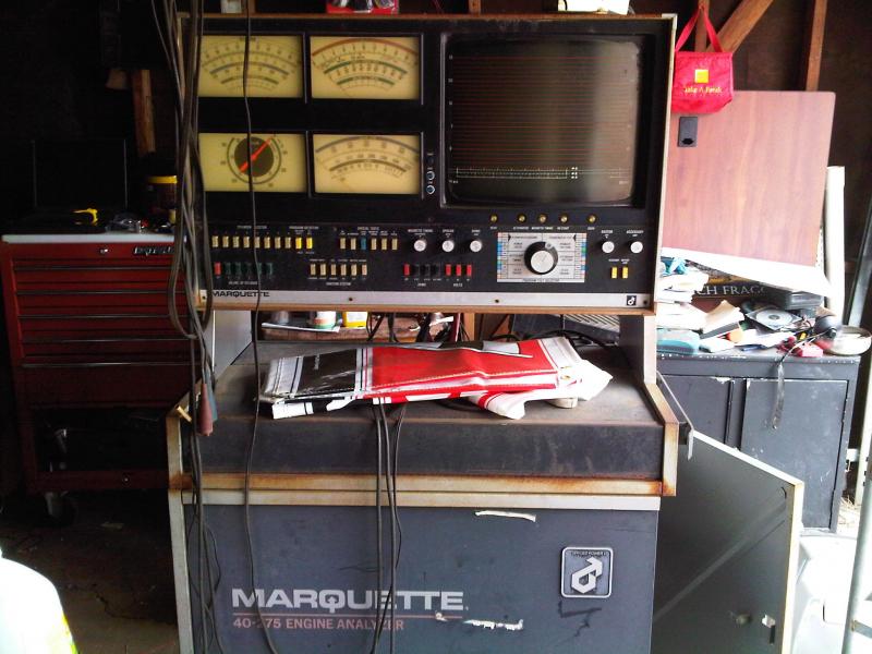

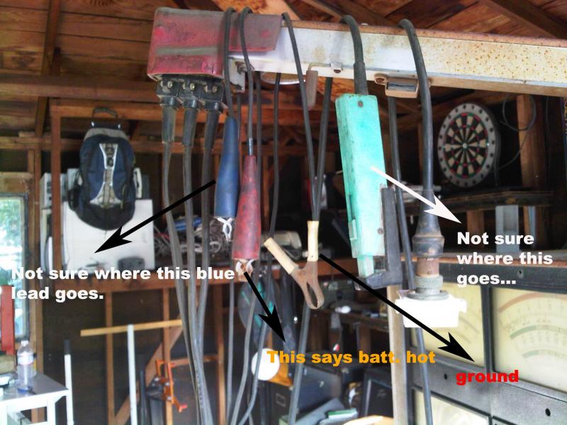

Just picked up a marquette 40-275 analyzer and have no idea what wires go where... Any know where I might get a manual or some directions for wire hook ups?

The marquette stuff was a very popular "value line" product. Have you searched online for information?
I work with peerless analyzers, they are very similar products to marquette as they were aimed at the same market...entry level/budget price.
Post pics of the machine and all the cabling, I'll tell ya how to connect it. That shit was new when I was in my prime, we had several of those in the community college auto tech program I taught in.
I do have a few operator's guides for the peerless stuff, like I said, the marquette is not much different.
Philbin electric in portland, or was a service center for the marquette products of all types, contact them for information also:

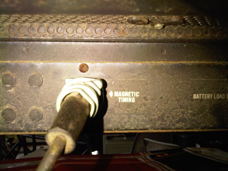

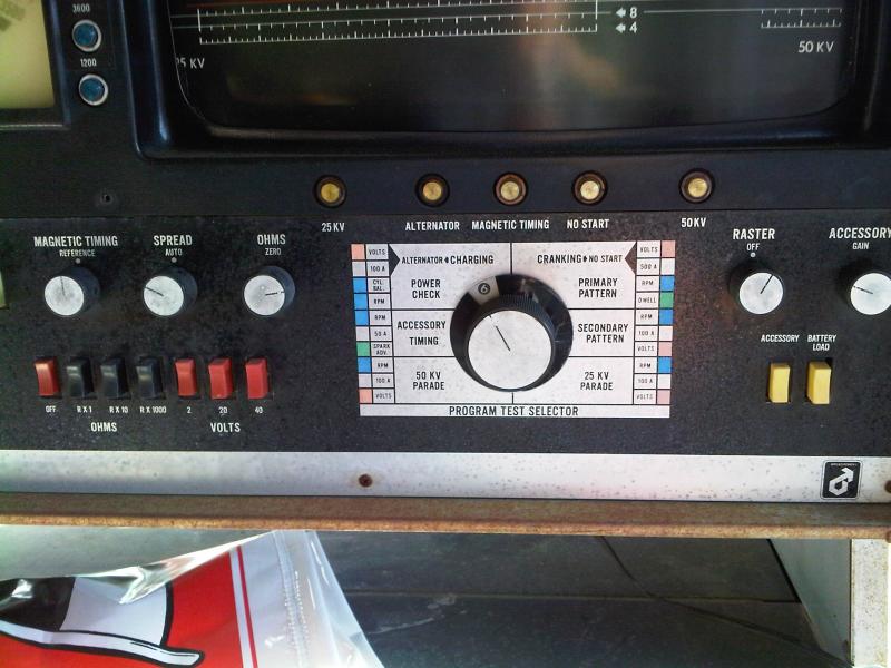

Yep, philbin rebuilds distributors and all types of automotive-related electrical apparatus, including blower and wiper motors. Great folks to deal with inna real old skool environment, the place looks like hell inside but that is because they are an old time business!
Your marquette is the pro version, very full-featured! Not the less featured versions sold through auto parts distributors. It is equivalent to the peerless pulsar "infra-red" version that lyle bought originally off ebay and has stored here now. He later bought a more modern model peerless he found at philbin's after making a trip there looking for literature for his first peerless unit!
It has a magnetic timing pickup to use on some vehicles that came into being in the late 70's, the first "computer" rigs. That timing pickup mounts in a holder down on the front of the timing cover on selected engines to provide a crank pickup signal for synchronization.
We can easily figure out a basic hookup for ya so you can play with this, no way to cause any damage.

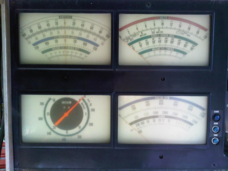

What I need is a set of pics with the test leads pulled out (such as laying on a table in front of the machine) so I can see where they actually enter the machine and show the label for each test lead. Not all test leads are used on all engine hookups. This machine was developed as a "bridge" analyzer between the older analog units made for breaker point ignition systems only that would also work on the "second generation" electronic ignition and charging systems coming into being at that point.
I also need a closer view of the front of the instruments and control console also.
Were there any additional "loose" test leads included with the machine or other adapters for coil towers, spark plug cable extensions, etc.??

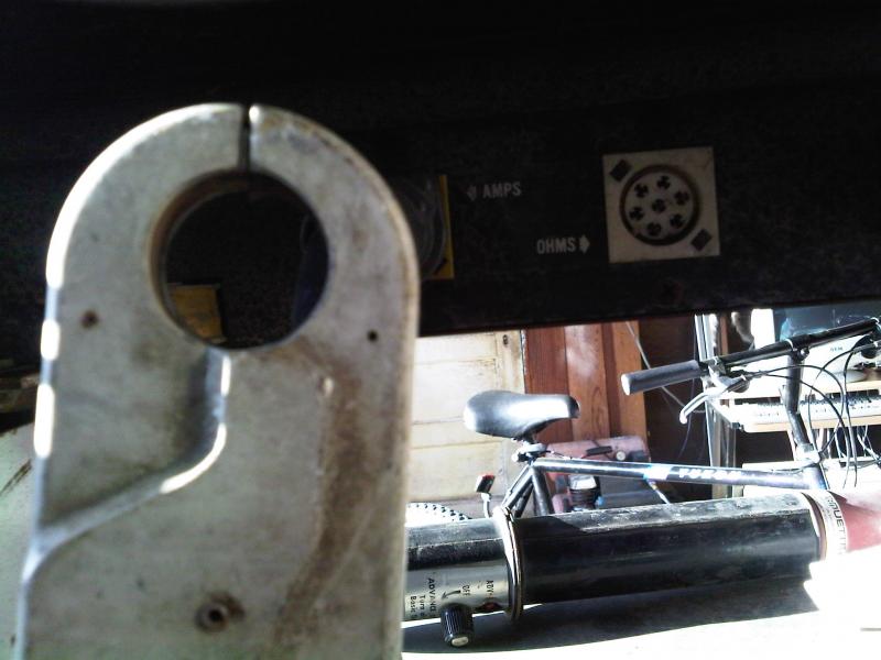

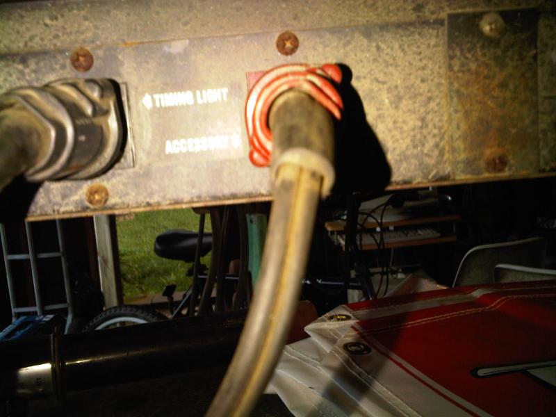

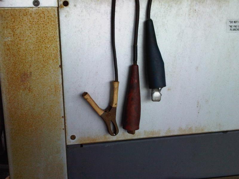

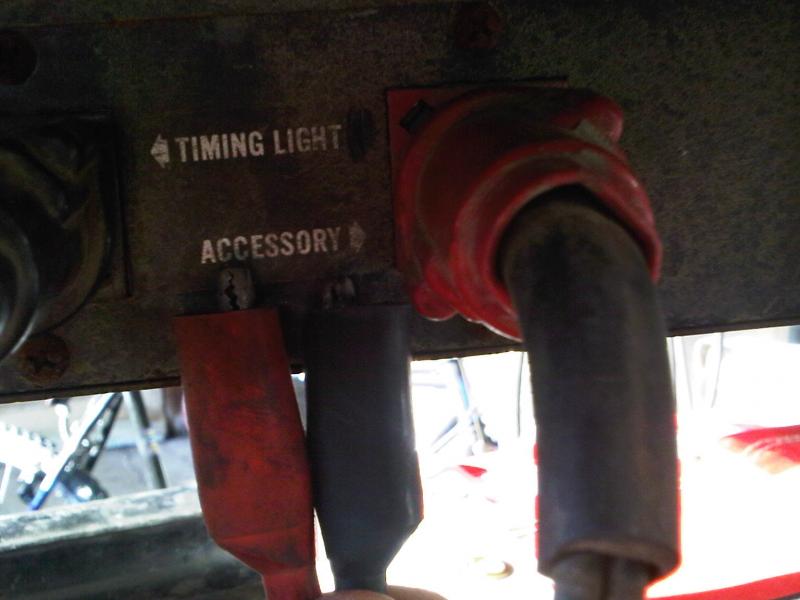

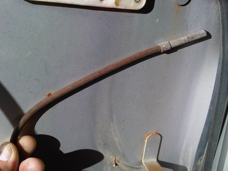

Done some searching but I've not found any decent info regarding your marquette machine online.
So let's start from scratch regarding the test leads. Keep in mind I May May be incorrect on a few points, we just need to work through this. I'm going to use your jpeg numbers posted for reference:

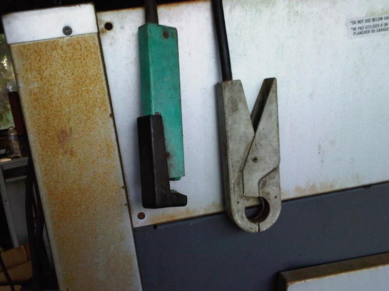

051: the aqua color lead is an inductive connector, it May have an arrow on it to denote directionality, if so, the arrow points to the distributor cap, connector goes on the coil lead to trigger the scope. I think...the blue connector goes to the coil negatve terminal and is used to trigger the dwell meter...follow that cable to the machine and see if it doesn't say something like "ignition primary" or "tach"? Does that lead go to the port labeled "primary ignition input"??

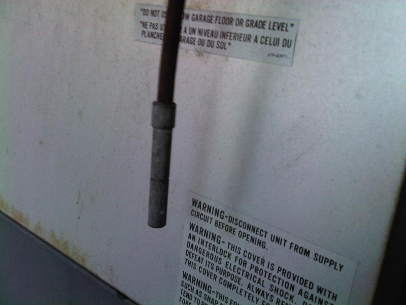

The two leads with the large battery clamps go to the battery positive and negative terminals. The smaller alligator with the red boot also goes to battery b+.

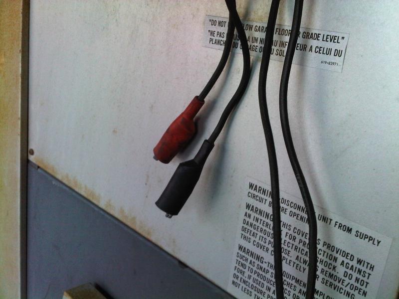

058: the small red and black alligators are used for measuring either resistance (ohmmeter) or voltage (volt meter), just like a handheld analog vom.

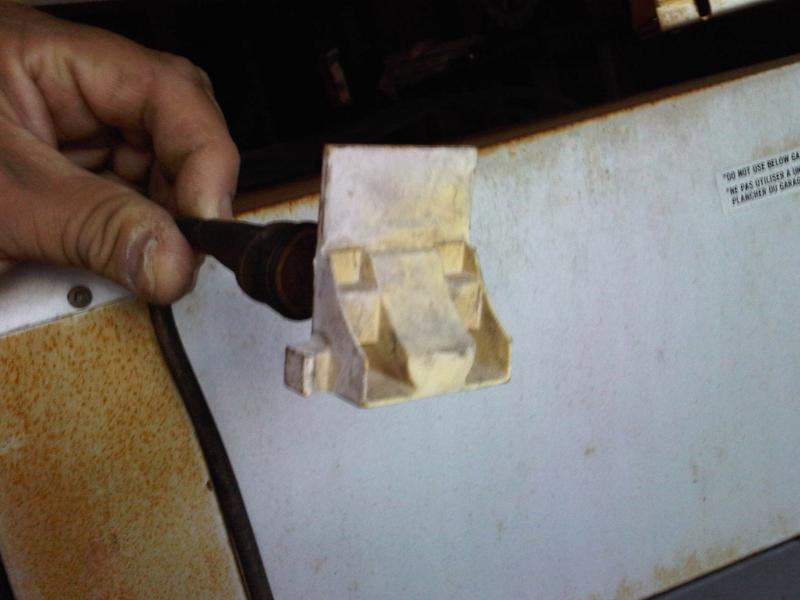

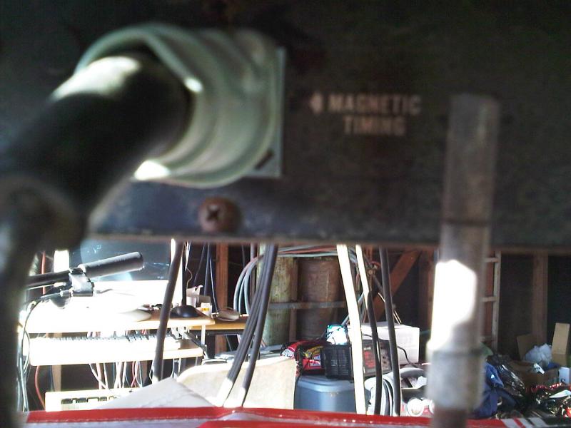

059/060: that is the mag pickup used on some engines equipped with a "holder" down close to the crank pulley/balancer that had provisions for "mag timing". That probe was simply inserted into the holder, roation of the crank pulley then triggered that probe and the timing number dis[lays on the analog meter. That system has no use on any IH-produced engine as they did not have provisions for a magnetic timing pickup (used instead of a timing light).
038: the large gray inductive clamp is for the timing light. Of course, on a sv engine it goes on #8 plug cable, and it May also be directional with an arrow that points towards the spark plug. I May be wrong, and have the description of the two inductive pickups transposed, determine where each lead goes on the boom and read the label for correct orientation.
040: I believe that white potted connector is used only on the delco hei distributor used in GM stuff. It snaps/clamps down over the top of the ignition coil mounted in the distributor cap. That is used instead of the pickup for the coil secondary lead and is used to trigger the scope for use only on an hei distributor.
057: I can see the timing light in the background. The note you see on the label refers to the fact that the light has the "dial-back" feature for testing the vacuum and mechanical advance segments of the distributor by. For basic timing readout, make sure the switch is either turned off or is set to zero (0), other wise the timing display will not be correct.
If the unit has a somewhat heavier gauge set of alligators and cables, those are used on the battery for a "load" test, that requires a separate adapter that goes on the battery positive post and is a large super-duty resistor unit that is used to momentarily "load" the battery to check the battery and charging system for discharge/charge operation. Those cables probably lead to the port connector labeled "amps".
The vacuum gauge will either have a fitting on the machine to use a simple hose connection that goes to an available manifold vacuum port on the engine, or...if it is an electric vacuum gauge, there is a small box with a cable that goes into one side and vacuum hose coming out the other side. That is a transducer used to convert an vacuum signal to an electrical signal to run the actual vacuum meter on the panel.
Does that account for all the test leads? If so, connect those up and gimme a pic of the setup on a live motor. Then I'll attempt to explain the test configurations, buttons to push, and the basic scope operation.

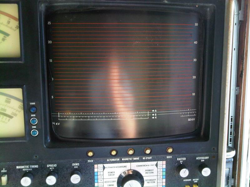

Thanks for all your help michael! The occilliscope doesnt seem to work. It's real shotty and I think it May have something to do with the selector dial (seems like the connection is worn out).
I need to figure out what I want to do with this thing.
Thanks again for all your help!
Rich

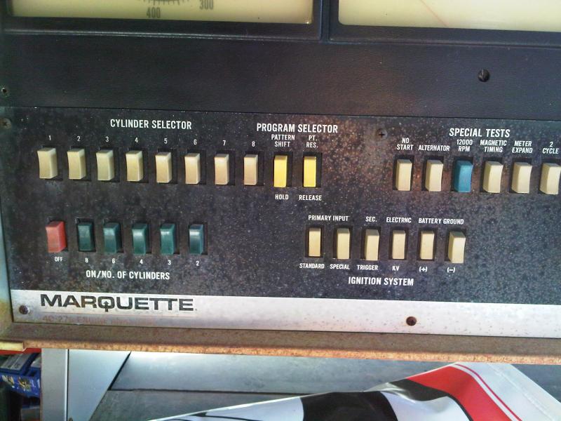

All these analyzers that use the push button banks have issues regarding dirty contacts in the switch mechanisms. All the years of atmospheric moisture, air-borne crap swirling' around in the shop(s), and plain old oxidation of the contactors takes it's toll. Sometimes they simply won't engage after repeated pushing and then all of a sudden one will lock in and everything comes to life!
I use compressed air and simply blow into the switch button areas over and over to flush out any dirt. Then come back and blow electrical contact cleaner into the switches while playing the button piano over and over! Then blow with air again. Then a final douche if they seem to start coming to life using a silicone spray. Then blow out with air again.
When ya remove the switch panels from each position and get 'em on the bench, it's pretty easy to clean and determine why they don't work. A bit of surgery usually brings 'em to life.
Does the scope light up at all? If not, there is a fuse for it somewhere, either in the back in a holder, or inside the cabinet. With no leads connected to anything, it should still light off and you would have a trace/"blip" crawling across the crt once you get the potentiometers adjusted just right for the pattern length and placement on the base line. Diddle with the knobs with it turned on. If it's a green background or a gray background, you should see it light off in a very dim form when power is applied.

I get the line on the scope, but it cuts out unless I rapidly keep moving the dial. Then I get a pattern at the top of the screen. But as soon as I stop wiggling the dial I lose it.
Do you know anyone who might be able to put this to use? I'm willing to give it away... I live in ojai,CA. Just don't have enough of a need to spend the time to get it to work. Should'nt have even bought it. Anyhow if you know anyone in the area who would like to have it and try to get it working again just let me know.

That indicates that the potentiometer is trashy inside (the rotary switch), I had the same thing occur with all these units I've scruud with! Cleaning all the rotary switches/pots I do the same as the pushbutton switches...it's all about internal corrosion/oxidation, this stuff is very sensitive!
You are in ojai??? Hail, man...you need this machine to complete your new age/biofeedback equipment array! Them spacealiens will beam right into your shop for a dose onna daily basis!
Any IH vehicle parked on the street in ojai is about as politically-incorrect as it comes! Yore my kinda dude! Ya got crystals growin' on the dash?
Post it up in the classifieds...sumbody will jump on it!
