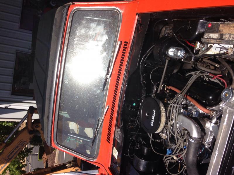

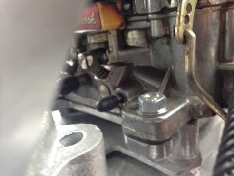

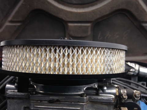

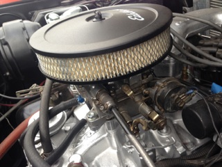

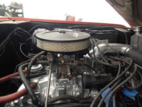

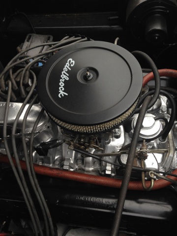

This is one pics I have to go to the shoo and get more later today more closer ones

At first look I thought you had the aluminum manifold...then I noticed the cap on the brake reservoir and the water neck look to be the same color so it's probably just painted. The part he needs to see is the base of the carburetor...I think mostly to see if it's an adapter plate which I agree is a worthless set up. The 2 bbl carbs go pretty good on the IH motor. Like I said and I know it's not everyones favorite but sitting on the proper manifold the edelbrock carb works pretty good. I have one on my 392 in my Travelall and get decent mileage and she runs smooth and never stumbles. I had a carter in my travelette before we went cummins, basically same as the edelbrock and I liked it there as well, I just extended the vent in case of a big slosh and it was a wheeling beast. Seems like I've pulled every Jeep in Nevada out of somewhere but maybe there are a few left.

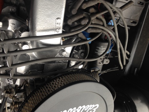

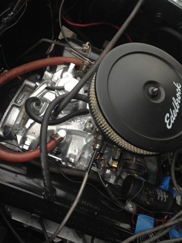

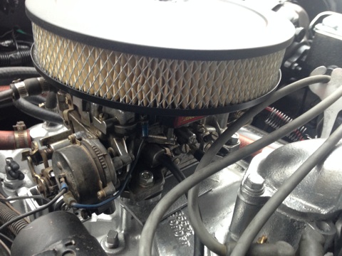

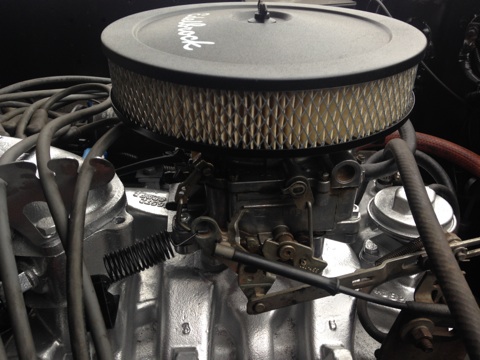

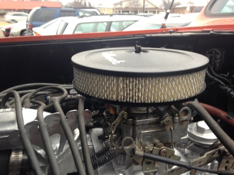

Size:  65.6 KBall pictures of the carb!!!!

Kind of hard to tell from those pics, but the last one looks like there May in fact be one of those worthless 4bbl to 2bbl adapters. So, my best suggestion to you is to ebay that edelbog and pop for a Holley list 0-7448, which by coincidence can be purchased from IHPA, the very fine vendor who makes this forum possible. That will be a much better solution for you than what you have on there now.

Yep you've got an adapter under that afb.
So......... There is no way you'll ever be happy with that setup.. My recommendation is to find a good used or new Holley 2300. Don't get a 500 cfm version. The stock one is adequate at 275 cfm but if that can't be found in reasonable condition, the 350 cfm 2300 list # 0-7448 that you can buy new.
This is the same one that sb74 recommended. See link below..
http://www.IHPartsAmerica.com/store/...448-p-car.html
