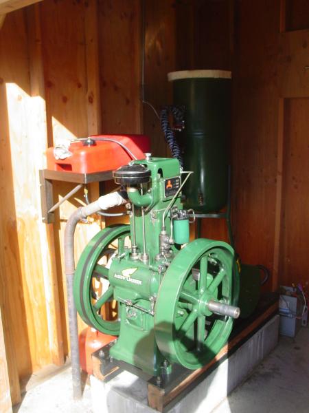

I'm with ya on the cranking speed. I have a hand crank diesel 4.5" bore x 5.5" stroke. It does make a big difference when it's cold!
