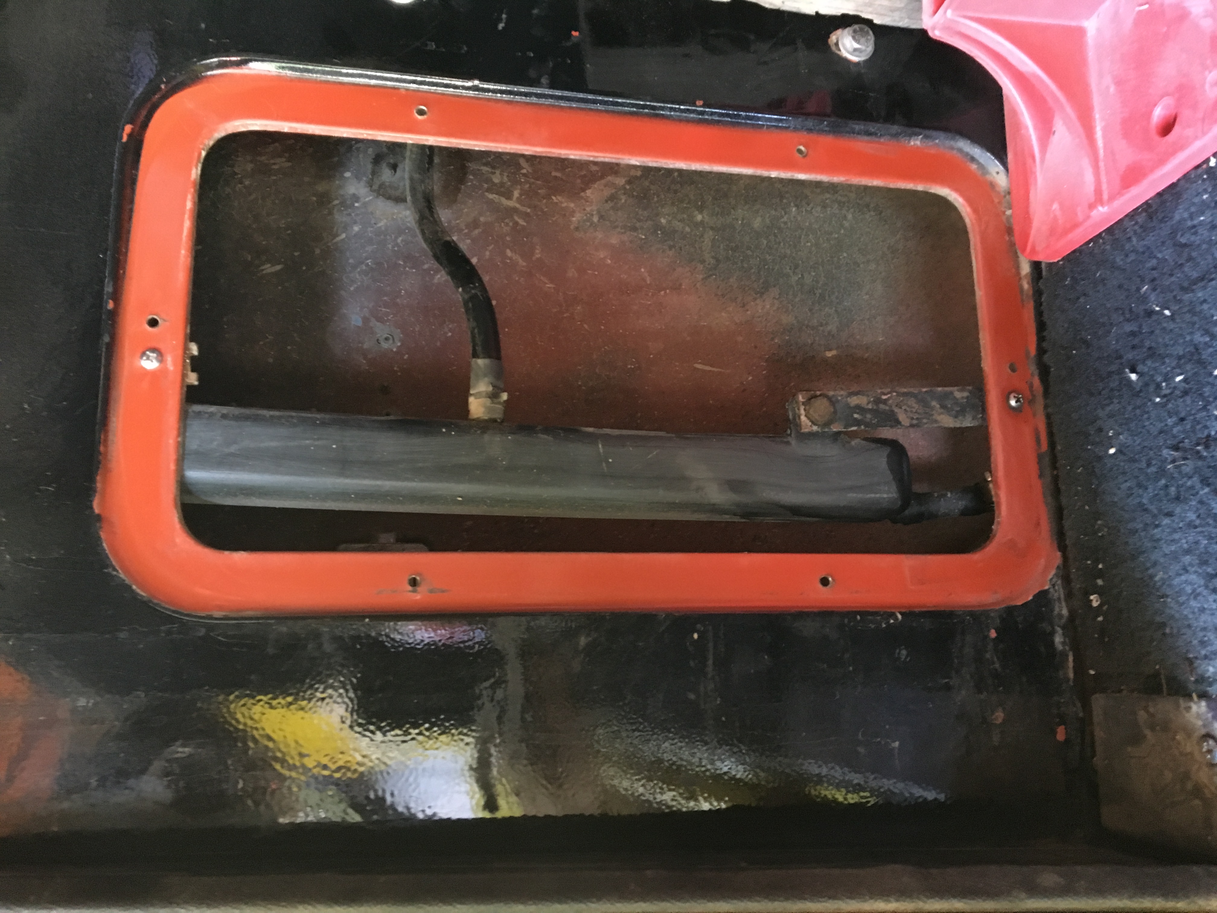

The filler neck nipple and all the "vent" (eecs system) nipples are located above the frame rail and many of ya know how difficult it is to deal with those connections when the connecting soft hose is old and rotten!
Whats that off white hose running through the middle of that photo??

Since mr. Mayben probably won't be on here any time soon, to reply back, I had to look back on page one to look at the photo.
That cream colored hose appears to be the vinyl hose that connects the evap unit mounted up inside body panel near the fuel filler. Then that same hose connects t9 charcoal cannister in the engine compartment.
