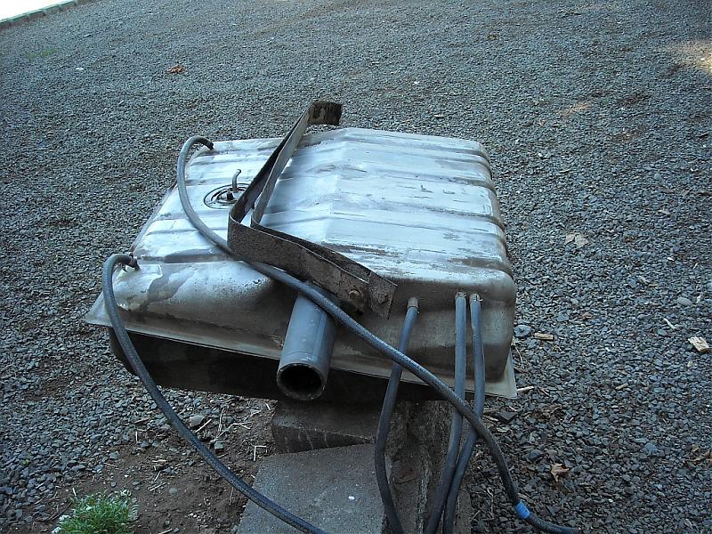

This first pic is a reference shot for Matt of the oem 19 gallon tank. This rig is a 1974 sii and has a completely intact evaporative emissions system which is functional. The oem tank is designed to "nest" into the space under the rear floor of an sii, between the frame rails. The top is contoured to fit adjacent to the rear floor and cross supports. The fuel feed to the fuel pump is from the sending unit mounted into the top surface of the tank, that follows standard practices in the automotive industry and is a major safety consideration.

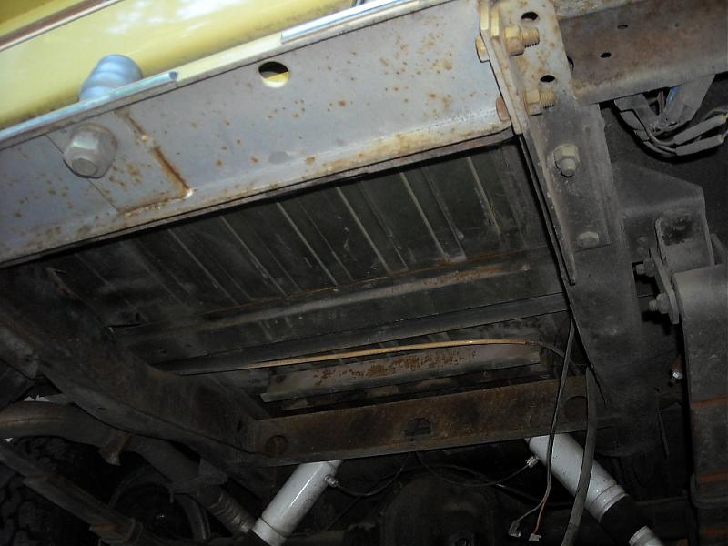

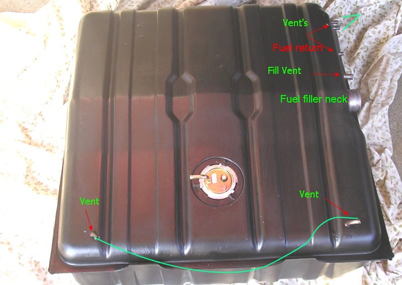

This shot shows the nest in the rear section of a typical sii where the oem fuel tank mounts. The floor support creates an issue where the top of the tank has to be contoured to provide clearance. And the frame intermediate crossmember dictates where the tank must sit in relation to the rearmost crossmember.
The filler neck nipple and all the "vent" (eecs system) nipples are located above the frame rail and many of ya know how difficult it is to deal with those connections when the connecting soft hose is old and rotten!

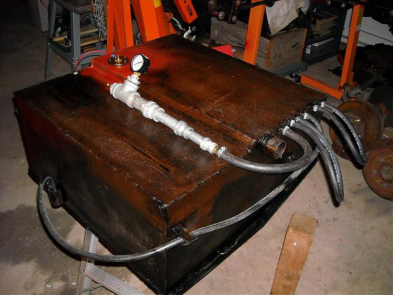

This is a general shot of the modded aftermarket 30+ gallon tank with the "skid plate" bottom added. Ya can easily see the crappy weld job, looks like the shit welds I do with the mig!
Since this tank was fabbed from sheet goods, the top had to be contoured during fabrication to follow the oem tank contour. Also, this tank does have the "sub-tank"-type baffle inside which is part of the eecs design. That is located in the "step-up" portion of the tank.

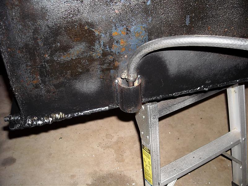

On each side of the tank ya can see the two triangular tabs welded to the side walls. These tabs are "stops" that contact the frame rails on each side. When the mounting straps are pulled up snug, those stops prevent any movement of the tank in it's mounting arrangement.
This tank has also had a npt bung welded into the bottom on one side to serve as a drain. That point was a big leak that I had to repair!
For pressure testing, the tank was blown up to 15psi and douched with a liquid soap solution. Once we thought we'd repaired all the leaks, it was pressurized one last time and then allowed to sit for several hours watching for "leakdown". After the tank was installed it was finished off with flat black rattlecan and plumbed, then we added five gallons of alkeegazz. If any leakage had been noted the flat black paint would really "bloom" and show any minute leak point, none has been found to this point.
The top of the tank had been previously modded by the welder for installing a typical aftermarket fuel gauge sender (five hole pattern). The light line sender available for the IH option 33 gallon tank and available through IHPA worked perfectly. I did "adjust" the float rod slightly to take into account the amount of volume that had been removed from the tank when the bottom was replaced. And yes...that replacement sender is the correct "10ohm>78ohm" sender used on all IH light duty vehicle fuel gauge systems that incorporate the 5vdc constant voltage regulator instrument system. So that sender will work with the oem Scout 80, and the Scout 800 fuel gauges also. I added an insulated disconnect to the sender gauge feed to allow easy access if the tank ever needed to come back down. A separate ground wire was also installed under one of the sender mounting screws and run to a ground point on the frame.
